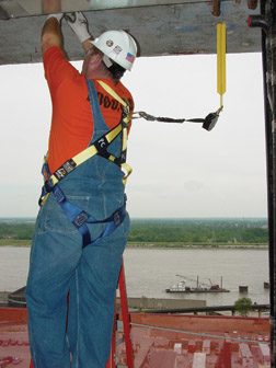

At the very least, workers from electrical contractor PayneCrest, St. Louis, follow OSHA and ANSI standards for fall protection, and it seems to be working. On April 4, the company closed out the day with an unprecedented 1 million consecutive hours of work without a recordable injury. David L. Payne, president, credits his company's safety record to an integrated safety program that includes training, equipment, and stringent requirements.
All of PayneCrest's project managers and field supervision personnel complete OSHA 30-hour training, and all of its electricians complete the 10-hour OSHA construction training, which includes the walking and working surfaces portion that covers ladders and other work platforms. As for fall protection equipment, PayneCrest requires fall protection systems for any height over 6 feet, and only veers from the course under equipment manufacturer specifications. “We tie off in rigs and lifts when the manufacturer requires it,” Payne says. “But there are some that don't want ties.”
PayneCrest provides all fall protection equipment for its electricians, including double lanyards, which are cleaned and inspected regularly. “The foremen inspect them as soon as they get to the job site,” Payne says. “We also send them out to a private testing company for inspection. Periodically, they're dated so that we can make sure they're all in good shape.”
