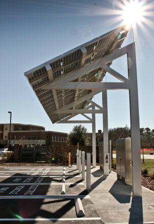

    In January, Palmer Electric completed the $170,000 electrical contract on the Smart Solar Plug-In Test Facility at the University of Central Florida (UCF), Orlando, Fla. (see Sidebar: Test Facility below). Funded by a research grant from the Florida Energy Systems Consortium (FESC), Gainesville, Fla., the $380,000 solar charging station (Photo 1) generates 50kWh of energy daily. When no plug-in hybrid electric vehicles (PHEVs) or battery-powered EVs are being charged, the two solar arrays on the carport feed energy into the main power grid of the campus. Currently, there are four parking spots (Photo 2), each with their own charging outlet on an aluminum pedestal (Photo 3). An additional two spaces have been equipped with conduits to support EV charging stations scheduled to be installed later this year when they become available. These two new stations will come equipped with SAE International's standardized J1772 connector (see Sidebar: Plug and Play).

    Use of the UCF solar carport is free for 10kWh of power or less. For more than that, there is a charge for the electricity from the campus' power grid. There is a plan to have a payment mechanism installed.

    For the UCF solar charging station, Palmer Electric routed the wiring from the PV panels into the structure, down the columns, into underground conduits, and finally up into the cabinets. The electrical contractor also installed the solar system, which comprises 48 195W bi-facial — meaning they can collect an extra 30% more power from light reflecting from under the structure — solar panels in two arrays, each with four strings of six PV modules. Generated solar power is grid-tied using two 5,000W DC-to-AC inverters. In case of a safety issue, there are two power shutdown buttons that disconnect the solar array from the grid and shut down the solar power inverters.

    The School of Electrical Engineering and Computer Science at the University of Central Florida, Orlando, Fla., plans to use the Smart Solar Plug-In Test Facility as a platform to test its DC to DC-into-EV conversion technology, which could potentially reduce the 10% conversion loss as experienced in the traditional DC to AC-into-EV-battery process by half. The school will also test technology to move energy from EV batteries to the grid, or Vehicle to Grid (V2G), which would allow the owner of an EV to sell stored energy back to the electric utility.
    In order to make it possible for students to measure the system's performance, reconfigure components based on test results, and install new technology, Matern Professional Engineering, Inc., Orlando, Fla., and Palmer Electric Co., Winter Park, Fla., designed and installed the project to include large equipment cabinets (Photo 1) so that entire sub-assemblies could be installed in a dry, clean environment for easy measurement and replacement. Wiring from the solar panels enters the cabinet in smaller strings — three panels to a string — so that students have the ability to route smaller amounts of power to their devices being tested. Several disconnects and measurement points were added along the power path to allow students to take measurements, and wires were labeled so that students can identify what they are measuring. Preplanning ensured that wiring was concealed and no additional access points would need to be cut into the clear anodized aluminum structure.
    “The structure had to allow future modification,” says Thomas G. Beard, president, Palmer Electric. “The design was in conjunction with the university's electrical engineering department. They had some unique requirements.”
