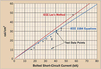

Fig. 1 shows a plot of the IEEE Std. 1584 reference equations and 600V test data for an open-air arc. An open-air arc is one that radiates the heat in all directions. A fault on a cable in an open tray could be considered an open-air arc. The calories/cm2 incident energy levels in this figure are based on a surface located 24 inches (61 centimeters) away from an arc that lasts 1.0 second. The line labeled “IEEE 1584 Equations” is derived from IEEE Std. 1584 equations (1 to 6) for an arc gap of 1.25 inches (32 centimeters). IEEE Std. 1584 also provides an optional equation based on Ralph Lee's method given in a 1982 IEEE IAS Transactions paper, “The Other Electrical Hazard: Electric Arc Blast Burns.” This equation is used for voltage levels greater than 15kV until future tests are done at higher voltages. The line labeled “IEEE Lee's Method” is shown for comparison to the IEEE 1584 Equations and test data. Lee's method is simpler because it calculates the maximum incident energy without knowing the arc details. The IEEE 1584 equations calculate an estimated arc current from the bolted short-circuit current and arc spacing. These values are then used to calculate the incident energy level. At 600V, the IEEE 1584 Equations and IEEE Lee's Method lines are actually higher than the incident energy test values.
Fig. 2 and 3 show the relationship of the IEEE 1584 Equations and IEEE Lee's Method lines for two additional voltage levels (4,160V and 13.8kV). In each case, some of the test data points are significantly above the IEEE 1584 Equations line. The IEEE Std. 1584 working group is aware of the apparent discrepancy and plans to make modifications to the equations at higher voltage levels once additional testing is complete. In the meantime, those engineers who use IEEE Std. 1584 equations may consider increasing the Cf constant in Equation 6 to at least 2.2 for added safety. This will increase the incident energy level by a factor of 2.2, which may result in higher-level PPE clothing requirements.
