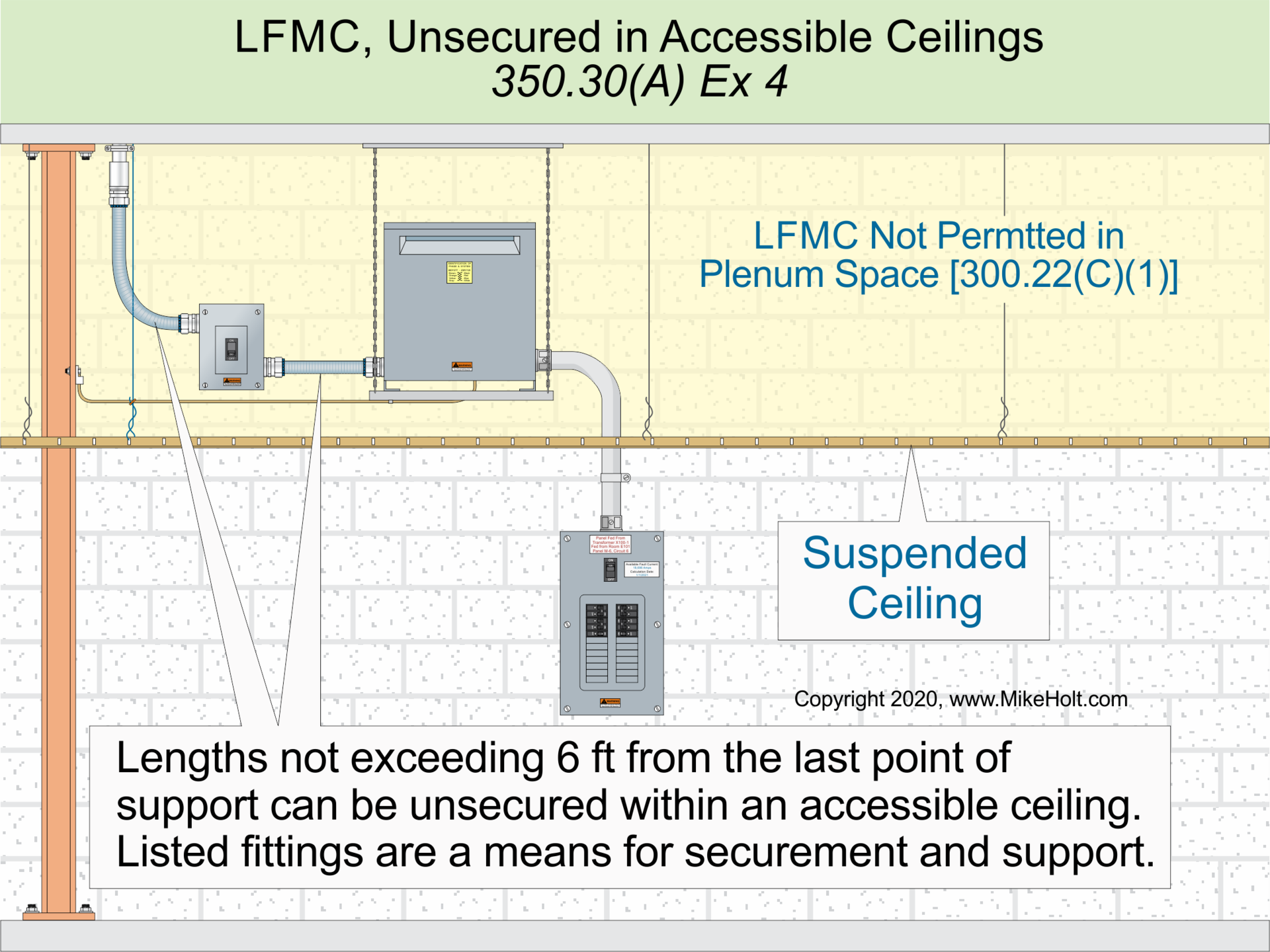

Exception No. 4: Lengths not exceeding 6 ft from the last point where the raceway is securely fastened can be unsecured within an accessible ceiling for a luminaire(s) or other equipment (Figure).
For these exceptions, listed LFMC fittings are permitted as a means of securement and support. 
Author’s comment: This last sentence following the four exceptions means that the use of LFMC fittings as the means of securing and supporting only applies to installations made using one of the four exceptions. It should not be misconstrued as blanket permission to use the fittings to secure and support the LFMC in all applications.
