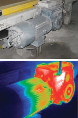

Motors. Thermal images of electric motors reveal their operating conditions as reflected by their surface temperature, capturing infrared temperature measurements of a motor's temperature profile as a two-dimensional image. Unlike an infrared thermometer that only captures temperature at a single point, a thermal imager can capture temperatures at thousands of points at once, for all of the critical components: the motor, shaft coupling, motor and shaft bearings, and the gearbox.
Ideally, you should check motors when they are running under normal operating conditions. All motors should list the normal operating temperature on the nameplate. And while the infrared camera cannot see the inside of the motor, the exterior surface temperature is an indicator of the internal temperature. As the motor gets hotter inside, it also gets hotter on the outside surface.
Remember that each motor is designed to operate at a specific internal temperature. The other components should not be as hot as the motor housing. Thus, an experienced thermographer who is also knowledgeable about motors can use thermal imaging to identify conditions such as inadequate airflow, impending bearing failure, shaft coupling problems, and insulation degradation in the rotor or stator in a motor (Photo 1).

Industrial gearboxes. Many industrial machines use gearboxes to alter and/or vary the standard speeds of electric motors. The lifeblood of any gearbox is the oil within it that lubricates the gears. If the oil level in a gearbox gets too low or loses its ability to lubricate, the gearbox will eventually fail, preceded by overheating. That's where thermal imaging comes in.
Traditionally, preventive maintenance for gearboxes has consisted of regularly checking their oil levels and replenishing lost oil. Some maintenance departments add a predictive element to gearbox maintenance in the form of oil sampling and analysis. These gearbox maintenance measures are time consuming and expensive and require shutting down the equipment. Also, gearboxes often are in inaccessible or unsafe locations that make oil-level checking and oil sampling difficult.
Use your thermal imager to detect when a gearbox is running hotter than similar gearboxes performing similar work in similar environments. Know the load on each piece of equipment, and check each gearbox when it is running at 40% or more of its usual mechanical load so measurements can be properly evaluated compared to normal operating conditions. Also look for leaking seals. Thermal images can reveal hot oil running down gearbox cases.
When you find an overheating gearbox, its thermal image may offer hints as to the cause of its abnormal operating temperature. Be aware that while all excessive heat generated in mechanical drive components is the result of friction, it may have sources other than inadequate lubrication. But whatever the suspected cause of overheating, you can arrange to follow up by checking the oil level, oil quality, and metal-particle content of the oil or perform acoustical testing or vibration analysis.
