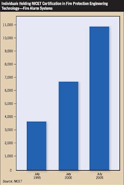

These types of requirements are seen with increasing frequency and are the source for the tremendous growth in NICET participation and certification over the last decade. In fact, the number of individuals attaining NICET Level III and Level IV certification has notably increased (Fig. 1 on page 39 and Fig. 2 above).
