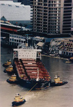

    As the fully loaded bulk carrier Bright Field navigated outbound in the lower Mississippi near downtown New Orleans on its way out to sea on Dec. 14, 1996, it suddenly lost propulsion power.
    The 735-ft vessel's main engine tripped due to low lube oil pressure, causing it to slow down as it passed the upriver span of the Crescent City Connection Bridges. As its stern cleared the second bridge, the pilot radioed the Governor Nicholls Lighthouse to warn the moored gambling boat, the Queen of New Orleans, of the impending crash. Hearing the radio traffic, the gambling boat staff quickly evacuated its 637 passengers. Upon seeing the approaching Bright Field, many people panicked. One patron jumped from the second floor of the boat and sustained severe back and leg injuries. Another jumped from the main deck to the pier and also suffered significant injuries.
    Striking the shore at a 45° angle, the floating skyscraper slid along the face of the wharf until it was parallel with the structure. When all was said and done, the accident left 66 people injured (three seriously) and caused $15 million in damages to the Riverwalk, adjacent condominiums, and several riverside rooms in the Hilton Hotel.

    Coast Guard officials identified several man-machine interface failures in this case. First, the boat was plagued by serious maintenance problems that could have equally affected main engine and maneuvering reliability. We found that the main engine's lube oil was extremely dirty, and the level in the oil sump was marginally low. Furthermore, the previous crew hadn't performed lube-oil replenishing activities prior to the start of the journey. In fact, it was unclear as to when, or if, the lube oil was ever changed.
    The secondary lube oil filter downstream of both lube oil pumps (main and secondary) served as a common point of failure in this critical system; dirt-induced flow restrictions in this lube oil filter choked off adequate oil flow and pressure to the main engine. The differential pressure switch located across the filter performed its job and notified the crew of a need to clean the lube oil filter. However, the crew paid no attention to this alarm.
    Much was also made of the standby status for the No. 2 lube oil pump, as solid evidence wasn't provided as to whether the No. 2 pump was or wasn't in the standby mode. Given the common choke point and the dirt-induced restriction downstream of the two lube-oil pumps, it's likely this issue is moot: Even if as many as four pumps were simultaneously operating, it's unlikely that sufficient oil would have blasted through the filter restriction to service the engine. However, given what appears to be purposeful activity in the Bright Field's crowded engine room just prior to the accident, it's unlikely the status of the No. 2 lube oil pump would have escaped notice. We believe the No. 2 pump was online and ready, as testified by the crew.
