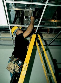

    Dispatched from a construction labor supplier, an electrician worked several days for an electrical contractor. He was found dead, dangling from his ladder, after his foreman asked him to “safe-off” a 277V circuit and then left him alone. (The task of safing-off involves insulating and securing the exposed ends of hot or potentially hot conductors.)
    After the accident, the victim's family sued the employer (electrical contractor) under the Serious and Willful (S&W) Misconduct exception to the workers compensation exemption that normally shields employers from big lawsuits. They claimed the electrician hadn't been properly instructed or equipped to work on energized wiring above 300V, as required by Cal-OSHA (California Code of Regulations Section 2320.2). The plaintiff alleged that 277V was part of a 480V system and confirmed OSHA's requirement that workers must use insulated gloves when working on energized circuits above 300V.
    In addition to his contention that 277V presents additional danger not present in 120/208/240V circuits, the family's attorney tried to prove this seemingly “routine” procedure was, in fact, complicated and dangerous because the victim was: 1) on a ladder; 2) working above a “T-bar” ceiling with many exposed grounds; 3) working from the back side of the metal box; and 4) working in a low light/poor visibility area. Considering these facts, the plaintiff maintained that the supervising contractor should have been on-site to enforce the OSHA Energized Wiring Regulation and therefore was negligent.

    What can we learn from this case? Technically, you “work a circuit hot” even when you merely connect an appliance. In other words, an electrician should always assume a circuit is energized — even if he knows otherwise. At one extreme, fully insulating yourself and making sure you have a solid footing may be overkill for “wire-nutting” two stripped 120V wires. At the other end of the spectrum, a wiring scenario such as the one presented in this case has all the tenets of a lethal situation and shouldn't be treated as routine, despite the ruling of this judge.
    Any time you're on a ladder and above a T-bar ceiling, particularly working with live 277V, you should consider yourself in grave danger of imminent death. You shouldn't work alone in the event you should accidentally come in contact with the circuit. Although it's easy to become distracted while doing routine tasks, this case demonstrates the importance of taking the small amount of extra time it takes to watch over yourself and your coworkers, making sure to use “hot-circuit” safety practices at all times.
