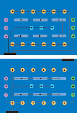

When configuring a fluorescent dimming system, the designer must specify control zones — that is, a fixture or group of fixtures that are controlled simultaneously by a single controller. For example, in a daylight-harvesting scenario with windows (Photo), the designer may place lighting circuits parallel to the window, and set up each circuit as a separate control zone. The smaller the control zones, the more granularity, or flexibility, you can achieve, along with higher energy savings. However, installation cost also increases.
Digital lighting control provides complete flexibility. When using analog dimming systems, the smallest zone is often a branch circuit. With a digital system, zoning is implemented using software, independent of circuits, using individual ballast addresses stored. Because each ballast is individually addressable, control zones can be established that are as small as a single ballast or light fixture. Ballasts or fixtures can also be grouped to provide up to 16 layers of controls/scenes, enabling highly granular and responsive control, the ability to generate a wide variety of zones and scenes in any controlled space, and the power to adapt to changes over time — even be completely reconfigured without rewiring. For large installations, you can network individual buses for the control of hundreds or even thousands of ballasts.

In a digital dimming system, a single set of control wires form a low-voltage control bus — sometimes inappropriately called a loop. Compatible ballasts and controls (up to a total of 64 devices — with each ballast having its own unique stored address) connect to this bus to provide control signal interaction (click here to see Fig. 1). For larger installations, multiple buses can be networked to proper scale (click here to see Fig. 2). The control bus provides two-way communication; ballasts can both respond to commands and reply to queries.
The digital ballast includes a microprocessor that functions as storage (ballast address, intensity settings, fade rate), receiver (control signals), and sender (intensity, lamp/ballast status) of digital information. DALI instructions, such as GoToScene and SetMax, are sent to the ballasts, using the data stored in its microchip memory. The ballast is not only “smart,” but it can also “talk back.” As the control bus enables two-way communication, the digital ballast receives commands and also responds with maintenance and energy information, such as the status of the ballast and lamps. This enables the lighting system operator to query ballasts for energy usage (using feedback such as Intensity-Setting), which can be used for a variety of purposes from energy savings verification to benchmarking to billing internal departments or tenants individually for their lighting usage. It also allows the operator to query ballasts for lamp and ballast failure (querying for a response such as BadLamp), which can improve the efficiency of lighting maintenance and improve customer service from the facilities department.

A single pair of control wires, which forms the bus, connect the ballasts and controls directly (Fig. 3), which simplifies wiring in spaces with multiple control zones by reducing the number of homeruns. The level of skilled labor is reduced because there is no need to pull wire according to a zoning schedule. Each ballast on the circuit is wired the same. There are no switch legs or three-way travelers. In addition, dimming control panels/modules are not needed to control light output. Instead, digital systems use a small power supply connected to the bus.
Digital ballasts can be wired into the lighting system using Class 1 or Class 2 wiring methods according to the National Electrical Code. Digital ballasts may use a Class 1-rated 5-conductor cable that uses one hot (live), one neutral, one ground, and two polarity-insensitive control wires, all routed together in the same conduit. It is also possible to install the ballasts and controls as a Class 2 installation, in which case the control wires must be routed separate from the power wires. Check with the ballast and controls manufacturers on whether their products are rated for Class 1 installation.
