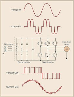

Motor compatibility and smaller drives. VSDs can also create motor compatibility problems, especially when retrofitting drives to older motors. The high-speed switching of the IGBT in conjunction with long cable runs can cause overvoltage reflections (also known as standing-wave voltages or peak-to-peak or corona voltages) with peak voltages two to three times the DC link voltage.
Many drive manufacturers will specify that cable not exceed 100 feet, but sometimes even this can be too long. These overvoltage reflections tend to puncture insulation on the first few windings of the motor, causing premature failure of stator insulation. This is a problem common to high- and low-horsepower drives with PWM outputs. But lower-cost, low-horsepower motors are especially vulnerable. Their stator windings are often random-wound, a less costly manufacturing process, but one that could create a high potential between adjacent wires, making them that much more vulnerable to overvoltage reflections.
At one time, low-pass filters were commonly placed at the drive output to reduce the overvoltages. In recent years, however, manufacturers have designed inverter duty motors rated at 1,500V specifically to withstand overvoltage reflections. (Inverter duty motors are specified in NEMA MG-1, Section IV, Part 31.) Many drive manufacturers now require you to use inverter duty motors with their drives.

Historically, heat dissipation needs made it difficult to build smaller drives. A drive first converts the AC sine wave into DC, then stores the DC power in capacitor banks in a section referred to as the DC link. The inverter then switches the DC to create a pulse width modulated (PWM) signal — a kind of synthetic AC. That process was a prime generator of heat.
In newer drives, however, a semiconductor device called an insulated gate bipolar transistor (IGBT) does the switching. Recent developments in IGBT design have resulted in greater current carrying capacity. Of more relevance in this context, however, is that IGBT switching speeds have become faster and faster, on the order of 100 to 200 nanoseconds.
