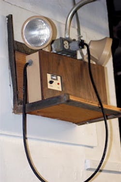

Where battery systems (including unit equipment) are involved, the NEC says tests shall be performed and written records kept of the results. However, there is neither mention of a specific time interval nor what the test should entail. Unit equipment always has a test button on the side or front panel. This normally on, single-pole switch cuts off incoming AC power to simulate an outage, so you might be tempted to hit the button and — if the emergency light goes on — call it good.

An important part of all inspections is to make sure the heads have not moved and are aimed accurately. These emergency lights are simple to repair, and it is rarely necessary to purchase a whole new unit. Typically, when you push the test button and all lights fail to go on or are weak, it's a sign new batteries are needed — but not always.
Most units are 6V and have a single 6V battery or two hooked in parallel. Some models are 12V with a short jumper to connect two 6V batteries in series. It's best to check batteries, even new ones, with a voltmeter. They should read about 6.20V. Sometimes, however, a battery will test good but have excessive internal impedance and hence be unable to drive two or more bulbs. You can either test the batteries in advance with a spare bulb or put them in the unit and see if they have taken a charge after 24 hours.
Sometimes, when new batteries are installed, the unit will test good but fail to light in a subsequent monthly test — a sign that the unit is not charging. In this case, you don't have to buy a new box. Electrical distributors sell sub-chassis components that contain charging apparatus and relays, which are also fairly easy to change right in place. It is common practice to disconnect and cap off the source conductors, change over all the wires, and then restore power by reconnecting the source conductors. The better practice, however, is to be OSHA compliant by finding the right breaker and cutting off the power — or you can just pull the power cord if so equipped (Photo 1). Of course, this will put out all nearby lights, so you will need to run an extension cord and trouble light from an adjacent branch circuit, unless there is a window nearby.
Other times, if you press the test button, the lights will energize but not go out when you release the button. If this happens, then the relay is sticking. If you rap sharply on the housing, the relay will often release. In this case, realize that the problem is sure to recur in the future. There is no way to lubricate the relay, so you'll need to replace it.
Occasionally, the unit will emit a continuous AC hum. Some circuit boards have a mini potentiometer, which can be adjusted to eliminate this sound. Typically, this does not provide a lasting cure, so it's best to replace the relay.
