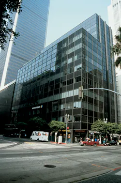

    The plan was simple: Upgrade the electrical power delivery system of an aging 20-floor commercial office building located in a prime downtown Los Angeles location in hopes of attracting high-tech tenants — particularly telecommunications companies (Photo). However, the engineers were forced to confront a problem that has become increasingly prevalent on such projects: electromagnetic interference. As offices are flooded with a deluge of computers, faxes, and printers, the location of electromagnetic field (EMF)-producing power equipment, such as transformers, switchboards, and power cables, and their proximity to those electronic devices are design considerations that can no longer be overlooked.

    As part of the power distribution upgrade, the building owners planned to substantially increase the power capacity by installing new 34.5kV utility transformer service equipment to accommodate the increased demand of the telecommunications switching equipment. The existing utility electric transformer and the building's main electrical distribution equipment were located in the basement parking area. Space and access restrictions precluded installation of the new utility transformer and supporting electrical equipment in the remaining area. After an extensive search for adequate space, the owner selected a 2,500-sq-ft, street-level retail space to house the new equipment.
    Putting the new electrical equipment in this location, however, meant tenant spaces filled with sensitive electronic equipment like computers and fax machines would be on all sides and above the new equipment room. This condition would have a significant effect on how the project's engineers implemented upgrade plans.
