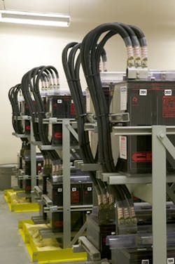

When choosing a UPS, electrical engineers must also consider the system's storage device. Rotary UPSs may use flywheels or batteries, while static systems typically use batteries. Depending on the size of the UPS and de-rating of the UPS module, the flywheel can provide backup time anywhere from 12 seconds to several minutes. Battery-based systems should be used for projects that require an extended run time of conditioned power beyond the few minutes that a flywheel can provide. The battery can provide backup power to the critical load for hours, if necessary, but with a longer runtime for a battery reserve, the cost of the UPS is increased. Careful consideration should be given if the backup battery is used for an extended length of time, especially when used with high-density IT equipment. Without continuous cooling flow, the power delivered to the IT equipment via the UPS may cause thermal runaway and shut down the IT equipment.
Although they provide larger amounts of power in order to cover an extended outage, batteries have several disadvantages to consider. They typically require equal, if not more, maintenance than a flywheel system. Without this maintenance, batteries will fail prematurely. In addition, they typically require more space for installation. Another consideration is battery storage, disposal, and maintenance. Because large quantities of batteries are necessary for facilities with continuous power requirements, the disposal of spent acids could also be in the hundreds of gallons.
