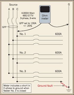

Example No. 3: Locating a ground fault in a power distribution system
A 4,000A, 480V bolted pressure switch has tripped on ground fault. Because this is the main for the facility, production has come to a halt. Except for emergency lighting, there are no lights. The electrician closes the switch, and it immediately re-opens. The decision is made to open the down stream feeder disconnects, close the main, and then close the feeder disconnects one at a time until the 4,000A main trips. Leading to a switchboard fault and fire, this procedure resulted in extensive equipment damage, loss of production, and a very close call for the electrician.
An investigation revealed the switch failed to open due to a damaged trip coil caused by the electrician repeatedly closing into a system fault. Breakers and switches are not designed to be closed into faults. The fault should be located, isolated, and corrected prior to re-energizing the service. OSHA specifically addresses this in the Code of Federal Regulation - 29CFR 1910.334(b) (2). Because of the potential for serious injury or death, “After a circuit is de-energized by a circuit protective device, the circuit may NOT be manually re-energized until it has been determined that the equipment and the circuit can be safely re-energized.” The repetitive manual closing of circuit breakers or re-energizing of circuits through replaced fuses is strictly prohibited.
Unfortunately, the procedure used by the electrician is a common practice in the electrical industry. But when you think about it, using a 4,000A, 480V switch or circuit breaker for locating any fault is extremely dangerous.

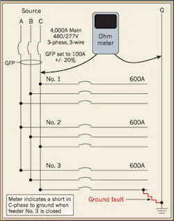

Once again, a safer procedure involves the use of a 9V battery in an ohmmeter to locate the feeder with the fault without exposure to the hazards associated with having line voltage present during the test (Fig. 2).
The first step is to leave the main switch or breaker open, and open all the feeder breakers. The next step is the most important one. While wearing the required PPE and using a properly rated voltmeter, test for both voltage phase-to-phase and phase-to-ground at the load side of the switch or breaker. Keep in mind that clearing a fault can stress and damage the insulation in a protective device. As a result, voltage can be present at the load side with the breaker open. If you measure voltage on the load of the breaker or switch, do not continue with the test. The breaker or switch may have to be replaced. Using the ohmmeter on the load side of the open switch or breaker, place one lead on ground and the other lead on the A phase terminal. The meter should indicate very high resistance (i.e., an open circuit). Check B and C phase-to-ground for the same result. Close one feeder at a time and check A, B, and C phase-to-ground.
You are looking for very low resistance (i.e., a short or closed circuit on one or more phases to ground). Some single-phase loads will give you a low-resistance reading, but the circuit that caused the trip will give you a reading close to zero resistance. If the fault is in a motor, the starter will be open, and you will need to check individual motor circuits at the load side of the starter to find the fault. After you locate the fault, continue to check all the feeders to assure there is only one faulted circuit.
Prior to re-energizing the main, you must first verify there is no damage to the switch or breaker caused by the original fault condition. Where applicable, test the device to assure it is suitable to be returned to service, consulting the manufacturer for specific instructions as necessary. While wearing the required PPE, close the main and one feeder breaker at a time, leaving the faulted circuit off until you locate and clear the fault on this feeder. Note: If a main protective device trips, the trip unit or ground-fault relay may be set too low for the system. Typically, the manufacturer sets the ground-fault pick-up to minimum 100A, ±20%. A coordination study by an engineer is required to determine the proper setting after the equipment is installed and put into service. Do not set the ground-fault pickup to maximum — this could create additional system coordination issues.
