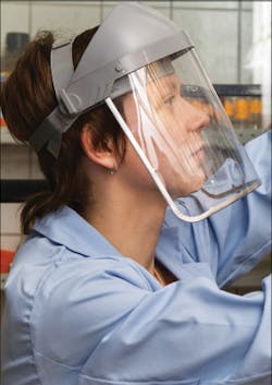

Chemical-Resistant Face Shields
A high-impact, chemical-resistant face shield made from Tritan copolyester for industrial applications is now available, thanks to a collaborative effort between Bullard, Eastman Chemical Company, and Spartech. According to the company, using this new material provides users with a single face shield for meeting high-impact strength and chemical-resistant requirements, offering improved durability and clarity while avoiding vision-impairing scratches that can be caused by flying debris. Tritan copolyester meets ANSI/ISEA Z87.1 2010 standard for eye and face protection and is available on all of the company’s face shields and visors.
