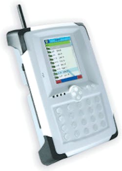

    Emergency lighting management system
    The Emergi-Lite Nexus emergency lighting management system provides real-time status of an emergency lighting and exit sign system, runs system diagnostics, performs required monthly and annual functional tests, generates maintenance logs, and runs compliance reports from a central control unit. Additionally, the system operates independently of emergency lighting and exit signs. Available in wired and wireless versions, the wired version uses a dedicated data cable network for areas where wireless communication is not possible. The wireless version uses radio frequency (RF) communication and 900-MHz mesh networking technology to penetrate dense building materials, including masonry walls.
