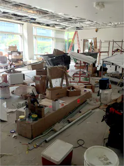

Photo 1. Other trades materials can easily pile up on the job site and get in the way of your own crews.

In today’s environment, contractors have to hide all these activities in their labor units. Because they can’t invoice these advance activities to the project (remember at this time in the project, there is no installation; therefore, the GC will not recognize the labor, and you can’t get paid for the intangible work you have performed), contractors often frontload the job by buying and dumping the material on the job site to improve their cash flow and benefit from razor-sharp margins on the material.
Photo 2. Stored materials can also get in the way of efficient work on a job site.
What’s wrong with that, you ask? Well, have you seen your job site lately? Does it look like what is shown in Photo 1 and Photo 2? When you have too much material on your job site, you waste labor to move stuff around when it’s needed. This could cost you as much as 40% of your labor cost due to lack of productive work. With the new FASB regulation, you can actually get paid for the pre-job and non-installation activities if you can track them and show how they contribute to fulfilling performance obligations in the project.
