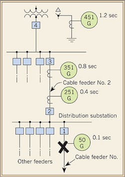

    Figure 1 shows a single-line diagram of a typical MV distribution system, where a distribution substation is fed by cable from a main switchgear lineup. Ground-fault protective relays are also shown. Let's analyze this system closer.
    What would happen if Relay 50G (for Feeder No. 1) fails? The answer is that Relay 251G would have to clear the fault before the shield in Feeder No. 1 is damaged.
    Sustained Overvoltages and MV Cable Ratings Shielding
    Looking upstream of Relay 50G, we see that the operating time of Relay 251G at maximum ground fault is 0.4 sec. With Relay 50G's operating time of 0.1 sec, Feeder No. 1's shield must be capable of withstanding its portion of the total ground-fault current of 1,000A for 0.5 sec without sustaining damage. This portion is 15% of 1,000A, or 150A.
    Suppose Feeder No. 1 consists of three No. 4/0 AWG, 15kV, shielded conductors in a rigid steel conduit without a ground wire. Its shield must be able to withstand 150A of ground-fault current for 0.5 sec. Similarly, Feeder No. 2 shield must withstand 150A of ground-fault current for 1.3 sec (0.5 sec for Feeder No. 1 plus 0.8 sec for operation of Relay 351G).

    The shield withstand curve shown here is that of a 4/0 AWG, 15kV, grounded, concentric wire strand shielded MV power cable. The dotted lines represent the required shield withstand limits of Feeder No. 1 and Feeder No. 2. Note that the required withstand limits fall within the performance characteristics of the shielding configuration used in the feeders.
