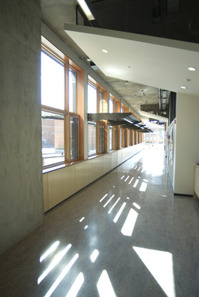

Energy efficiency alone is important for building owners, tenants, and for environmental stewardship. One of the obvious solutions is to turn off unneeded lights, a task easily performed by occupancy sensors. However, it's also vital to turn down or reduce overlit areas. Spaces are overlit by lighting designers to make sure adequate light is available — even in poor lighting conditions, dark furnishing, etc. By reducing the high-end light output, energy is saved anytime the fixture is on. Another option is to take advantage of natural light. By reducing electric light levels proportionally to sunlight, a lighting system can harvest the sunlight, increase comfort, and reduce the consumption of electricity.
