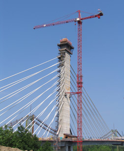

The Penobscot Narrows Bridge extends 2,120 feet over the Penobscot River and is the state's first cable stay bridge, connecting the town of Prospect with Verona Island. Two 447-foot pylons flank either end of the edifice, with the westerly Prospect pylon housing the observatory and its four-level glass observation deck. The 42-story observatory, accessed via a speedy 50-second elevator ride, offers 360-degree views of the Midcoast and Down East, Maine.

“What made this project unique was planning for the staging of materials and tools to support the work because of the limited work area and the number of trades working at the same time,” says Wade Stedt, E.S. Boulos' project manager at the time of the bridge and observatory's construction. “Another issue was the activity taking place above and below where we happened to be working and the safety aspects involved. For instance, cranes would be operating to build the tower, and our men would be working on the deck or on the ground level. You also had work taking place on the bridge level and up in the pylon towers. People had to be aware of that.”
