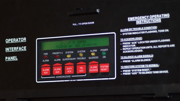

A medium-sized control panel with touchpad for alarm and trouble silence and system reset is shown above. Referring to the installation manual, you can use the touchpad to program the system’s many options.

  • A control panel, containing programming and operating electronics and user interface, is fed by standard branch-circuit wiring and contains replaceable circuit cards — one for each zone. This includes an alphanumeric display, showing the state of the system and providing troubleshooting information, and a touchpad so that onsite personnel can silence an alarm or trouble signal, reset the system following an event, and reprogram if necessary (Photo on page C10).

Operational issues. A fire alarm system operates in one of three (or more) states: normal, alarm, and trouble. The state is reported at all times on the alphanumeric display. If the system goes into alarm, the indicating appliances throughout the building go off. These could be very loud horns for some occupancies, or softer chimes in others, such as a nursing home.
The control panel monitors the initiating device circuits at all times for shorts and open wiring by means of the applied DC voltage. The initiating devices are normally open. In the event of a fire they become conductive at close to zero ohms. How, then, is it possible for the control panel to differentiate between a non-alarm state and an open wiring fault? This is accomplished by means of an end-of-line resistor.
A 4.7 kilohm (typically) resistor is placed across the line after the final device. When this resistance is seen by the control panel, normal status is maintained. If the resistance increases, it means that an open has developed, and the panel goes into the trouble state. A buzzer sounds to alert maintenance personnel but the much louder horns throughout the building do not go off. The alphanumeric display will read something like “Open Circuit in Zone Three.” The trouble alert can be silenced by pressing a touchpad location under the trouble alert LED.
The control panel also monitors the functionality of its own wiring and zone cards, and trouble is reported in the display.
A low-level voltage is applied to the indicating appliance circuits when the system is normal. This voltage is not sufficient to set off the horns, but it is monitored as part of the control panel's supervisory function. If current ceases to flow, the trouble alert buzzer sounds, and the display indicates the presence of an open circuit.
Several troubleshooting techniques are appropriate when the system enters the trouble state. Initially, you can unhook a zone in the control panel (after disabling the system) and place an end-of-line resistor across the output terminals. This will simulate a zone in place and the actual field wiring (including devices) can be worked on while the rest of the system is operational. Another approach is to break the zone at the middle of the run and insert an end-of-line resistor. Using the “half-splitting” troubleshooting method, as discussed in “Maintenance Facts” on page 16 of the November issue, you can easily pinpoint a fault — either short or open.
