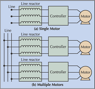

Harmonic attenuation. As the name implies, you'd typically use line reactors on the line side of a VFD, as shown in Fig. 1 at right. Harmonic compensated line reactors are specially designed to handle the waveform's harmonic content. By inserting inductive reactance into the circuit, which is a high impedance to harmonic frequencies, line reactors reduce the amount of harmonics produced by a VFD system. For harmonic reduction purposes, you typically apply 5% impedance line reactors to the input of motor drives 20 hp and higher. This reduces input harmonics to 35% total harmonic current distortion (THID) or less and minimizes the effects of harmonics on motors and other devices powered off the same electrical system.

In situations where you have drives located very close to the incoming facility power source, such as a substation, they may be susceptible to any incoming spikes and other transients. This is because there may not be enough impedance (in the form of transformers, power feeders, and the like) to help counteract these transient voltage spikes. This situation can damage the front end (diode section) of the drives or cause nuisance overvoltage tripping on the system. Installing a 5% impedance line reactor at the input to each drive helps counteract line spikes, keeping them from tripping or damaging the drives.
On the other hand, if you have drives located far from the facility power source (as often seen in hospitals), they may be affected by line harmonics caused by other harmonic-generating equipment (nonlinear loads). In most applications, harmonic problems are best solved at their source. Look for large nonlinear loads, such as VFDs, and apply a 5% impedance line reactor on the input to those pieces of equipment to minimize the system harmonics.
