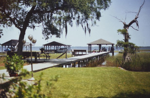

Lake Waccamaw is a beautiful lake with depths that average 6 ft to 10 ft in most places and 2 ft to 3 ft along the shoreline. Many lakefront owners have a long walkway leading out to a wooden dock. This particular covered dock, located about 200 ft out on the lake, contained a picnic table, barbecue grill, motorized boat lift, ceiling fans, and two staircases that descended down to the water's edge — overall, a very nice place to swim and enjoy the lake (Photo 1).
On this day, the grandfather/grandson duo decided to go swimming in the open area where a boat would have been located. Because he did not own a boat, the grandfather lifted the metal rails of the boat lift about 2 ft out of the water, operating a 1-hp motor connected to a pulley system with metal cables. Normally, the grandfather let the rails sit in the water.

As they were enjoying themselves in the water, several neighbor children (ranging in age from eight to 13) decided to join them. Everyone gathered under the shade of the covered dock, in and around the raised metal boat lift and 3 ft of water (Photo 2).

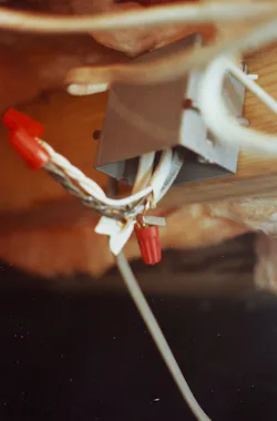

The dock was fed by a UF (underground feeder cable) 12-2 rated cable with ground, which was routed from a junction box located in the house's crawl space (see Fig. 1 and Fig. 2).
A UF cable is suitable for direct burial in the earth. A portion of the UF cable ran along the edge of a deck, exposed to the environment and foot traffic. Fed from a 20A circuit breaker at the main panel, a bare ground wire in the junction box appeared awkwardly twisted onto a shorter ground wire. I later learned from the town's electrical inspector that he had found this wire hanging out of the junction box, and it was severed at that point (Photo 3). Upon seeing this, he had reconnected it, to prevent any other ground issues.

The electrical inspector also informed me that he had located and opened a sealed standard plastic junction box under the wood dock and above the water line. He identified that the internal wires served the boat lift motor and were spliced to the house wires with twist-on connectors. When he removed the cover screws, water poured out of the box. He identified that the ground (green) wire and the phase (black) wire of the 120V UF cable were on the bottom of the box. I noticed a line on the inside of the junction box, suspecting that this was identifying the water level inside the box, with the two wires clearly being below the line (Photo 4).
The house panel's circuit breaker for this circuit did not have a ground fault circuit interrupter (GFCI) as per the 1995-1998 NEC, Art. 555, Marina and Boatyards. I noted that the boat lift motor had two GFCI devices connected in series, in between the boat lift and the plastic junction box, located near the boat lift motor switch.
This made me ask myself: If there were two GFCI devices in series, how did the electricity get from the black (hot) wire to the metal rails of the boat lift? The motor casing was metal, and was directly attached to a metal plate, which was attached to metal cables supporting the metal rails. Therefore, an internal short in the motor's casing would energize everything back to the metal railings. Or maybe the two wires in the junction box below the water line were the source of the short. Either way, the severed ground wire under the house would not have allowed anything to flow back to the panel's ground bus.
A ground wire provides a safe return path to ground for any leakage or fault voltages. An internal motor short would result in tripping the circuit breaker, or leakage imbalance would trip the GFCI circuit. However, with the ground wire severed at the house, electricity could not flow on this wire. Therefore, there would not be a GFCI sensed voltage imbalance at the lift motor to trip the unit. Both GFCI circuits were on the up side of where the short to ground was located. Effectively, this said the GFCI became unusable as soon as the ground wire became severed.

I made a second trip back to the house and took along my digital meter and some hand tools. I decided that if I could prove or disprove one of the two possible causes, the answer would fall out. In order to examine the motor for an internal short, I disconnected the ground wire going from the house to the motor and then energized the motor via the power switch. I made a voltage measurement between the motor's ground wire and the ground wire going back to the house. I measured 0V, which told me that there was no voltage on the motor's casing. Therefore, the only other path would have to be through the water-filled plastic junction box, back to the motor's ground casing, and down the metal rails. No ground connection back at the house meant the metal rails remained energized until a grounding connection could be made somewhere.

However, how the water got into the gasketed, sealed, junction box remained somewhat of a mystery. The wiring feeding the junction box was encased in two plastic conduits, but they were not sealed from the outside humid environment, possibly accumulating condensation over time. The section routed toward the house stopped about halfway along its length. The other section was routed vertically partially up to the GFCI connector. Therefore, both ends were open to the elements.
I also noticed that the plastic junction box was located directly under a seam in the deck boards. If the cover was not sealed completely, its location would be ideal for water to drip into the box. Either way, it was likely that the internal water buildup took a long time, possibly starting from the first day that the uninspected wiring was installed.
