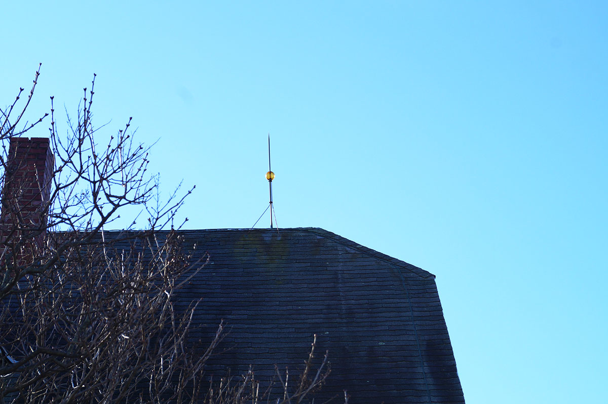

Every year I spend the holidays with my mother in Wisconsin. Each time I’m there, I look outside her living room window and see the lightning protection rod on the roof of the house across the street. It has always amused and perplexed me why a lightning protection system would have been installed on a house built in the middle of Wisconsin in the late 1930s. But there it is in all its glory.
