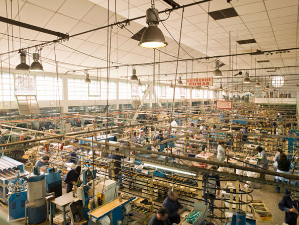

    2. Single structure large enough to make two services necessary. An example would be a large manufacturing facility.
    Manufacturing facilities often run into a situation covered by the third exception, which has to do with capacity [230.2(C)]. One of the three types of this exception is where the capacity requirement exceeds 2,000A (at a supply voltage of 1,000V or less).
    The fourth exception, for differing characteristics, is yet another one you see in manufacturing facilities (among other places) [230.2(D)]. Suppose the facility has some processes that require medium voltage (MV) or motors that run on same. These are specific loads for MV. The balance of the plant requires 480V (with appropriate stepdown transformers for internal distribution). An
