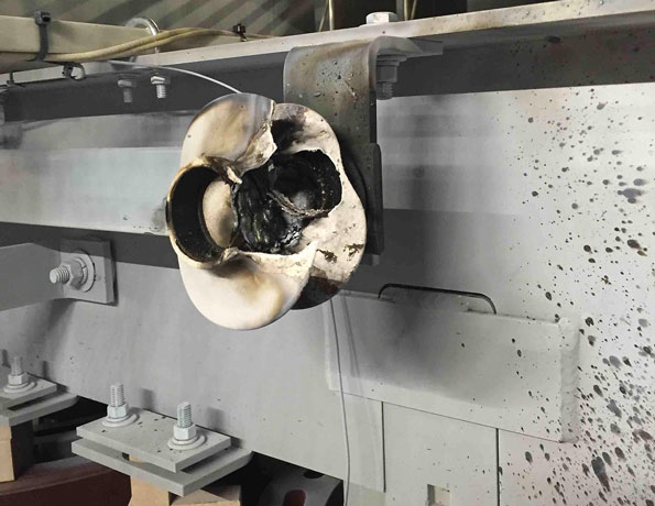

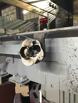

Photo 1. One of the failed arresters in emergency switchgear “A.”

The following day, RMF was on-site to look into the cause of an arrester failure. The surge arresters installed on the emergency transformer were found to have a rating of 3kV (2.55 MCOV), which was not suitable for RMF’s resistance grounded system. The correct rating for this system is 6kV (5.1 MCOV). Fortunately, the surge arresters in the adjacent medium-voltage switches that were feeding the transformer were rated correctly.

The next day, the paralleling switchgear manufacturer was attempting to again load bank test the relocated emergency generator, and the emergency generator breaker immediately tripped when closed to the 5kV paralleling switchgear bus. The third-party testing agency attempted to close the breaker several times, and it tripped each time on loss-of-phase detected by the differential relay. The breaker for one of the two new emergency generators tripped for the same reason. It was at this time that smoke was detected, and the failure was located in emergency switchgear “A.” A combination of the “A” and “C” surge arresters failing in emergency switchgear “A” caused the smoke (Photo 1).

Even after identifying the incorrectly sized 3kV arresters, the team still needed to determine the cause of the arrester failure — improperly sized 3kV arresters should not have reached a high enough voltage to fail on their own.

At the conclusion of testing, RMF found that the “A” and “C” phase surge arresters failed to ground during testing of the relocated emergency generator, most likely due to a voltage elevation during governor testing, which introduces transient voltages. This caused the voltage on “A” and “C” phases to become elevated, resulting in the failure of the surge arresters on those two phases. Since the NGR for the relocated emergency generator was not connected to ground, a ground fault current could not have been detected by the protective relay, which is why breakers didn’t operate sooner to protect the transformer.
