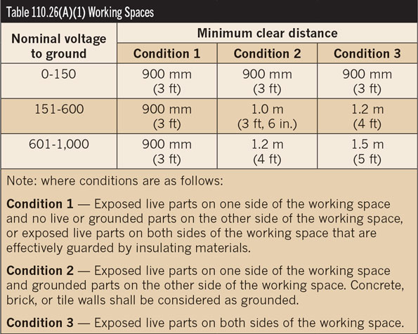

This is a reproduction of the table as it appears in the 2014 edition of the NEC.
The next question is: How much working space depth must be provided? Table 110.26(A) provides the answer based on the system voltage level and the applicable condition category (Table).
The easiest way to understand these categories is to use example installation scenarios. Let’s consider a common example of a 480/277V front-access switchboard installed in the electrical room of a commercial building or school. The working space required would be 3 ft (Condition 1), unless there are grounded parts or other electrical equipment on the other side of this working space. The installation condition criteria impacts how close the electrical equipment can be placed to other objects in the electrical room. Consider the case where there is a concrete wall on the other side of the working space. The concrete wall would be considered a grounded surface, so an additional 6 in. of working space (3 ft – 6 in. for Condition 2) must be provided.
