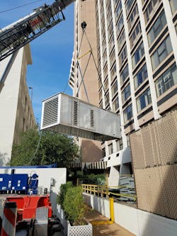

Whether portable or installed, retrofitting facilities with generators poses design challenges. Many are older and not physically or electrically configured to easily integrate units sized to run HVAC or all a building’s load. Tying in a portable generator can be especially tricky.
“This is fairly easy to do in a new facility, but in an existing one that may be 40 years old it’s harder,” says Michael Dodane, president of MiGre Engineers, LLC, an MEP design firm in Longwood, Fla. “It can be hard to find AC systems that might be on 10 different panels.”
To try to economize, Rebholz says, some owners have been wanting to explore establishing small cooling zones in facilities. That might translate to savings on generator capacity, he says, but facility wiring issues could be offsetting. On the flip side, some are interested in spending more to size generators capable of powering a facility’s full load.
