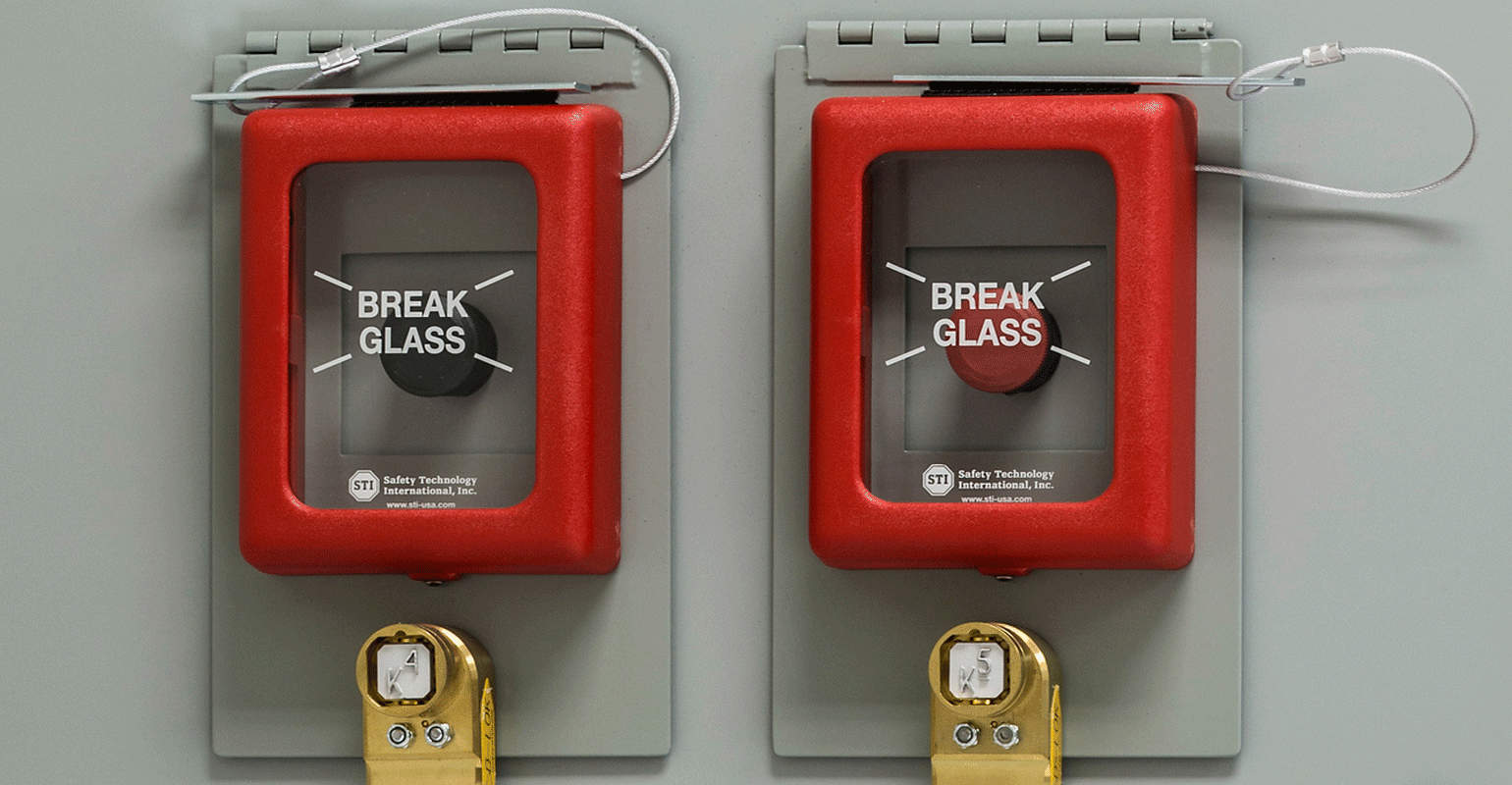

For those who design, manage, or operate critical facilities, one topic that causes significant anxiety and concern is the shutdown of power and mechanical systems through an automatic or manual emergency power off (EPO). In its traditional sense, the EPO originates from the National Electrical Code (NEC) and requires the familiar shutdown buttons near the entrances to an information technology (IT) equipment room. However, the NEC is not the only requirement for emergency shutdown of power and cooling systems.
Depending on the characteristics of the facility, other standards include requirements for automatic shutdown of power, mechanical systems, or both. Following is an overview of all applicable codes and standards that might require automatic or manual shutdown as published by the National Fire Protection Association (NFPA) and the International Code Council (ICC). This is not intended to be a comprehensive list of all standards referencing shutdown; however, they are the most likely to be adopted by local authorities having jurisdiction (AHJs), and therefore, come with a legal code requirement.
NFPA 70 – National Electrical Code
The primary necessity for a traditional EPO originates from Art. 645 of the NEC, which provides design requirements for electrical systems serving IT equipment, primarily within an IT equipment room. Article 645 is organized as a supplement for special occupancies to the general NEC requirements that would otherwise have to be followed in all other installations. If a space is designated as an IT room per Art. 645, much more relaxed wiring methods are permitted to be used within an environmental air plenum.
From an electrical power wiring perspective, Sec. 300.22 does not allow the use of liquid tight flexible metal conduit (LFMC) or any other non-metallic coated wiring methods within an of environmental air plenum. Likewise, Secs. 320.30, 330.30, and 350.30 require significant securing and supporting of installed cables.
Article 645 allows LFMC to be installed within an environmental air plenum, and does not require it to be secured in place if it is serving IT equipment. It also allows for much more relaxed wiring methods for communication wiring, so long as it is adequately fire resistant or routed in an approved raceway. For operators of data centers or similar spaces, these eased requirements provide highly beneficial flexibility for serving IT equipment through a commonly installed underfloor air plenum. However, this flexibility comes at a cost. For IT rooms, Sec. 645.10 also needs to be complied with. This calls for an approved disconnecting means to disconnect power to all electronic equipment and HVAC equipment, as noted specifically in 645.10:
“An approved means shall be provided to disconnect power to all electronic equipment in the information technology room or in designated zones within the room. There shall also be a similar approved means to disconnect the power to all dedicated HVAC systems serving the room or designated zones and shall cause all required fire/smoke dampers to close. The disconnecting means shall comply with either 645.10(A) or (B).”
The cost of the more flexible wiring methods is the requirement that you install an EPO system for your data center or equipment room. This EPO system must not only disconnect power to the critical IT equipment within the space, but also disconnect power to all dedicated HVAC systems. These requirements are provided to mitigate the additional fire risk associated with the eased wiring methods within an environmental air plenum and allow qualified personnel to quickly and easily disconnect power within an IT equipment room in the event of a fire emergency.
