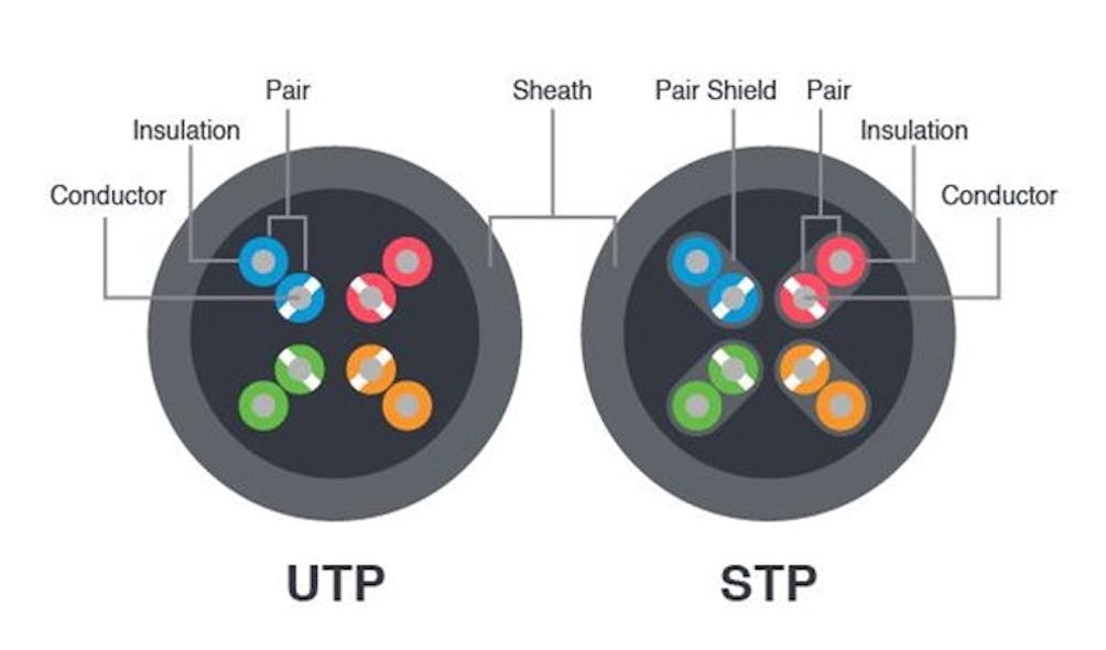

Cabling standards
The Category 6a (or Cat 6a) Ethernet cabling standard further increased bandwidths from 250 to 500 Megahertz (MHz). It also reduced the probability of interference due to crosstalk and enabled faster data transmission rates (up to 10-Gigabits per second) across longer cable lengths. Cat 6a is backward compatible with Category 6 (Cat 6) and legacy Category 5/5e standards. Two versions of twisted pair cable are supported — STP (shielded twisted pair) and UTP (unshielded twisted pair), as shown in Fig. 2.
