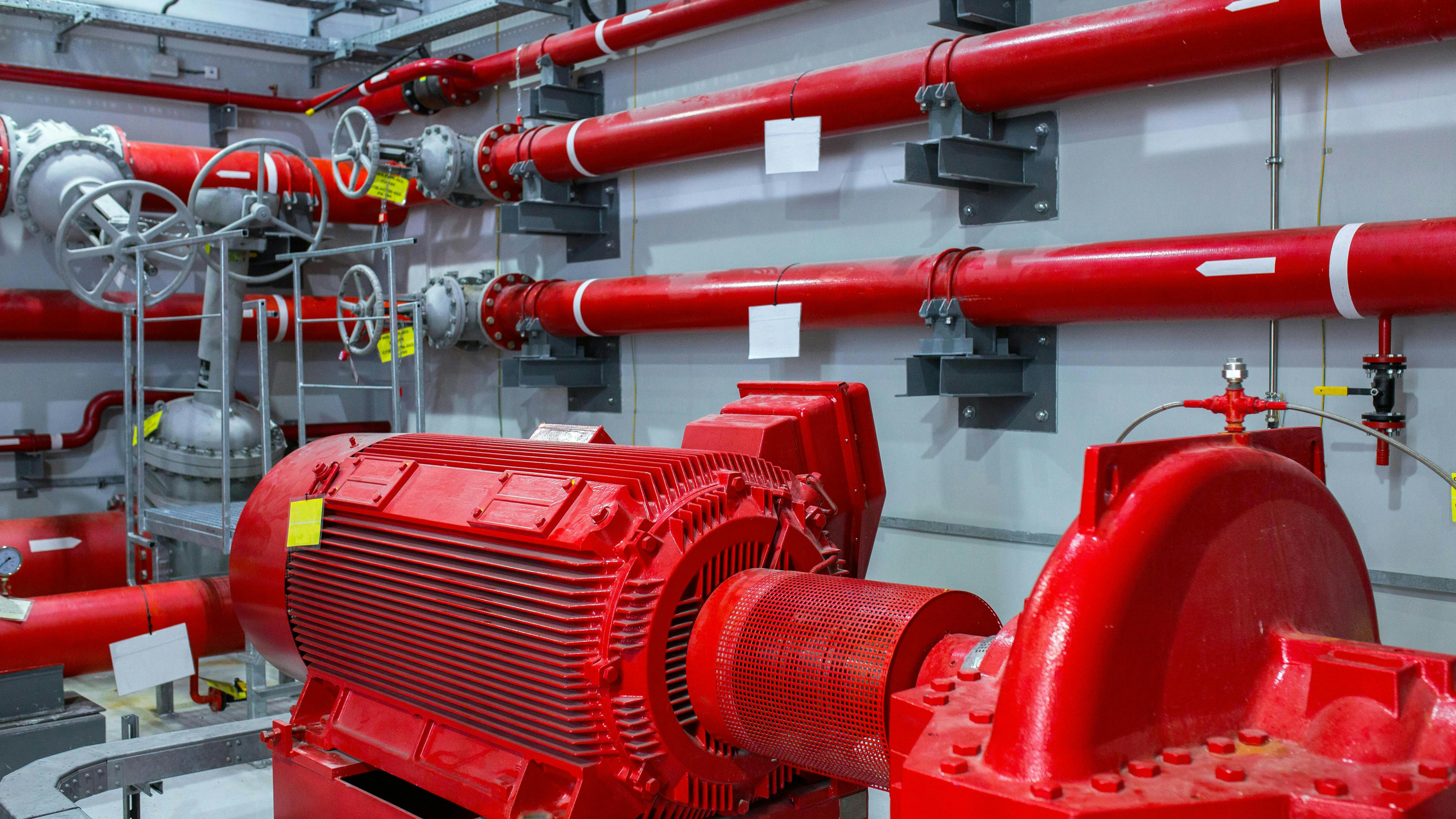

Setting the stage
The idea behind the electric services to fire pumps is to maintain the operation of the pump for as long as possible under the worst possible conditions. The oversizing of the normal source overcurrent protective device at lock rotor current (approximately six times the rating of the motor) is to allow the motor to continue operating even in an overcurrent and/or overheating condition without the device tripping. This is the opposite approach of what the NEC requires for any other piece of equipment in a building — where the overcurrent protective device is there to protect both the equipment and conductors.
In earlier editions of the NEC, the reason for routing the conductors outside the buildings, or concrete encased within the building, was to protect the building from possible fire caused by the overheating of the conductors. The 2023 NEC implies the reason is to protect the conductors from conditions within a building, such as a fire. However, both these conditions are met in the current NEC.
The power source(s) for electric motor-driven fire pumps
As per NEC Sec. 695.3 Power Source(s) for Electric Motor-Driven Fire Pumps, “Electric motor-driven fire pumps shall have a reliable source of power.”
I have never encountered a situation where the local inspector argued that the electric utility service was not considered reliable, but I assume it could happen. If so, you might want to consider using a diesel-driven fire pump in place of an electric-driven fire pump. The other option would require a generator as an alternate source of power to an electric fire pump with the primary source being electric utility power.
Assuming the electric utility source is reliable — and the building is not high-rise construction — the following would apply:
NEC 695.3(A)(1) Electric Utility Service Connection. A fire pump shall be permitted to be supplied by a separate service, or from a connection located ahead of and not within the same cabinet, enclosure, vertical switchgear section, or vertical switchboard section as the service disconnecting means. The connection shall be located and arranged so as to minimize the possibility of damage by fire from within the premises and from exposing hazards. A tap ahead of the service disconnecting means shall comply with 230.82(5). The service equipment shall comply with the labeling requirements in 230.2 and the location requirements in 230.72(B).”
The above allows three different approaches for serving a fire pump. The first approach is to have the electric utility company provide a separate service lateral for the fire pump. Because it is a service lateral, the electric utility company will include a grounded neutral conductor, along with the phase conductors, requiring termination in a switchboard with a neutral disconnect link. The fire pump service entrance-rated switchboard will also include a utility meter and main disconnect device. The Code does not require the fire pump to have a disconnecting means, but most electric utility companies will. This approach would not be my first choice, as the electric utility company would generally tap the same utility transformer as the building’s permanent service to serve the fire pump, meaning two service laterals from the same source. It would also require a utility metering section and would be the most expensive of the three approaches. For an example of this approach, see Fig. 1.
You will notice Fig. 1 includes a jockey pump, also known as a pressure maintenance pump. The purpose of the jockey pump is to maintain constant pressure in the sprinkler system piping. This ensures that if a sprinkler head is activated, the loss of pressure would be sensed at the fire pump controller, causing the fire pump to automatically start.
The second approach, very similar to the first, would have only one service lateral to the building and then tap the bussing in the utility pull section of the main switchboard, ahead of the utility meter and main disconnect device, for service to the fire pump switchboard. This is an extension of the service lateral, so the electric utility company would again require termination of the grounded neutral conductor and neutral disconnect link in the fire pump switchboard. The fire pump service entrance-rated switchboard would also include a utility meter and main disconnect device. Of the three approaches, this would be the second most expensive. For an example of this approach, see Fig. 2.
The third approach is my preferred method for fire pump services. It requires a vertical section of switchboard (nominally 18 in. wide), between the utility meter section and the main disconnect section, where the switchboard bussing is tapped to serve the fire pump disconnect. In this case, only a fire pump disconnect is required because the tap occurs downstream of the utility meter. These tapped conductors shall meet the requirements for service-entrance conductors and include the grounded neutral conductor to the fire pump disconnect, where it should be bonded to the main building ground. It is my preferred method due to the simplicity of the installation and because it is the least expensive (Fig. 3).
