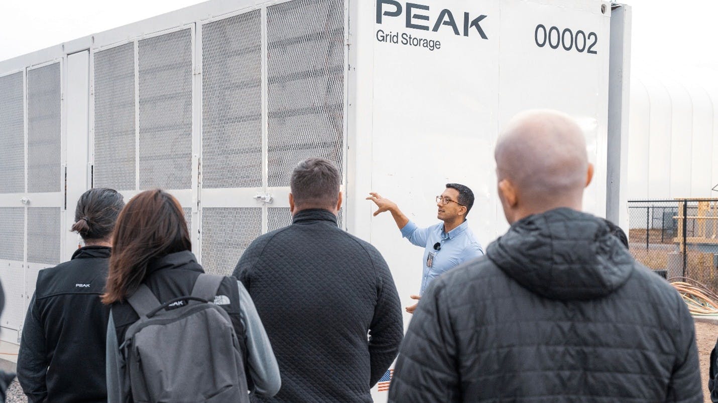

Peak Energy, Broomfield, Colo., announced Nov. 12 that it will furnish the sodium-ion battery technology it is refining to Jupiter Power, a six-year-old Austin, Texas-based firm that is an emerging player in the utility-scale battery power storage sphere.
The agreement calls for Peak to deliver its product to Jupiter over a potential three-year period beginning with a firm initial 720MWh slug in 2027. After that, if an option is exercised, it could provide another 4 GWh of storage through 2030 that would bring the total contract value to more than $500 million. The deal, Peak claims, marks the largest single deployment so far of sodium-ion batteries and comes just three months after it deployed its first unit at a Colorado test facility and began a pilot test of its system with nine utility and independent power producer customers.
