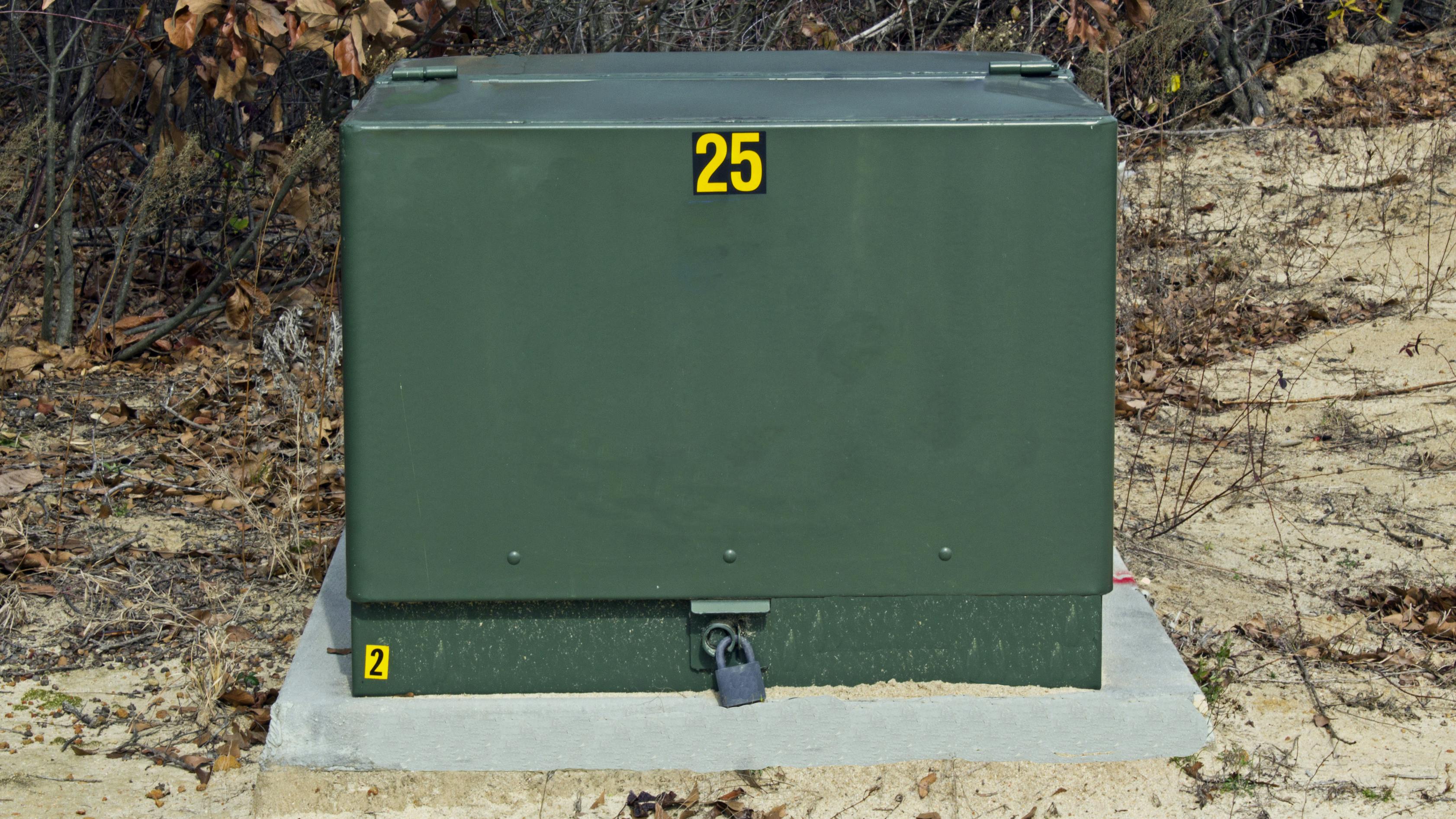

Oil-insulated transformers are required to have several safeguards, depending on the degree of hazard. The required safeguards are as follows: space separations, fire-resistant barriers, an automatic fire suppression system, and an enclosure that confines the oil from a ruptured transformer tank. Photo 2 details a pad-mounted transformer with FR3 insulating fluid, which is considered a less-flammable liquid.

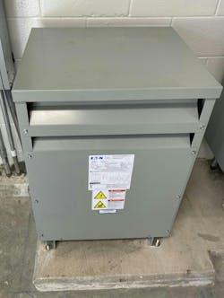

Dry-type transformers do not contain a liquid cooling system, which is advantageous for fire safety (Photo 3). These transformers rely on ambient air as the cooling source, so they require ventilation openings in the walls of the enclosure and/or heat sink cooling fins. That means dry-type transformers work best indoors; however, they can be installed within an outdoor-rated enclosure. It is generally recommended to use dry-type transformers for smaller power applications involving low voltage.
Most designs are advised to limit these transformers to low-voltage (480V-240/208/120V) applications, and to not exceed 300kVA. Article 450 outlines requirements for dry-type transformers. For instance, dry-type transformers greater than 112.5kVA must be located in a transformer room unless meeting an NEC exception, and dry-type transformers greater than 35,000V must be installed in a vault.
