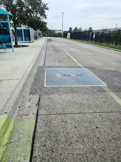

Wireless bus charging
Wireless bus charging is a modern and sleek charging configuration in which the charging unit is generally mounted in the ground, allowing buses to park over the unit to charge wirelessly through inductive power transfer (IPT) technology (Photo 3).
This installation type automates the connection process for charging, eliminating the need for drivers to manually handle heavy cables to charge the bus. When compared to the pantograph method, there are no moving mechanical parts, leading to a reduction in maintenance. However, wireless charging systems have several disadvantages. IPT technology has a larger upfront cost than other charging alternatives and generally operates at lower efficiency than direct bus plug‑in charging technology. Wireless systems also have slower charging rates and may require additional maintenance because the charging technology is embedded within the roadway.
