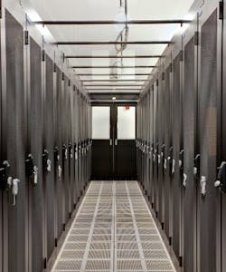

Intelligent aisle containment: The efficient and well-established practice of hot/cold aisle alignments sets up another movement — containment. Aisle containment prevents the mixing of hot and cold air to improve cooling efficiency. Both hot-aisle and cold-aisle containment systems are available.
