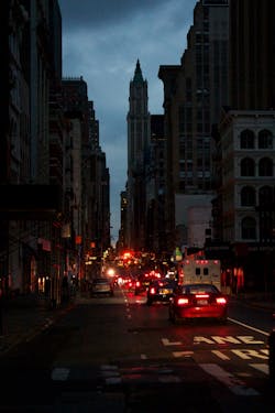

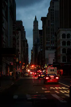

Uncommon darkness settled on the eerily empty, blacked-out streets of Lower Manhattan in New York on Oct. 31, 2012 (Jannis Tobias Werner/Shutterstock.com).
“Being electrical people, we were struck by the same things in that cover showing a darkened skyline, especially the realization that every one of those buildings probably had some kind of requirement or provision for back-up power, yet many of them apparently hadn’t worked,” Burke says.
While that photo was revealing, likely hundreds of facilities across the metro area did indeed have emergency power that ultimately worked as designed, even after experiencing temporary glitches in some cases. So, in that sense, the image may have overstated the extent and impact of the actual blackout and its duration.
