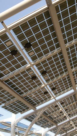

Renewable distributed energy generation technologies — principally wind and solar photovoltaic (PV) installations between 1kW and 5MW located close to the point of consumption — are one way around costly investment in transmission systems, according to a new report, “Fuel Cells for Residential, Commercial, and Industrial Applications: Market Analysis and Forecasts,” published by Pike Research, the Boulder, Colo.-based market research and consulting firm that provides in-depth analysis of global clean technology markets. The report reveals the use of renewable energy distributed generation experiences strongest growth in areas of the country with the highest prices for conventional electricity combined with the highest levels of environmental consciousness. Simultaneously, with technological advances and resulting cost reductions, renewable energy distributed generation technologies are generating power at prices comparable to grid-produced electricity.
For example, a 500kW PV system was recently completed on the roof of a historic building at a former military installation in Watertown, Mass., purchased by Cambridge, Mass.-based Harvard University in 2001. The project was made possible through a $1.1-million rebate provided by the Massachusetts Technology Collaborative, Westborough, Mass. The system is owned by Crimson Solar, LLC, a wholly owned subsidiary of Integrys Energy Services, De Pere, Wis. Harvard has committed to buy the power generated from the system and the associated renewable energy certificates, for 25 years at a predetermined rate, with no up-front capital cost.
