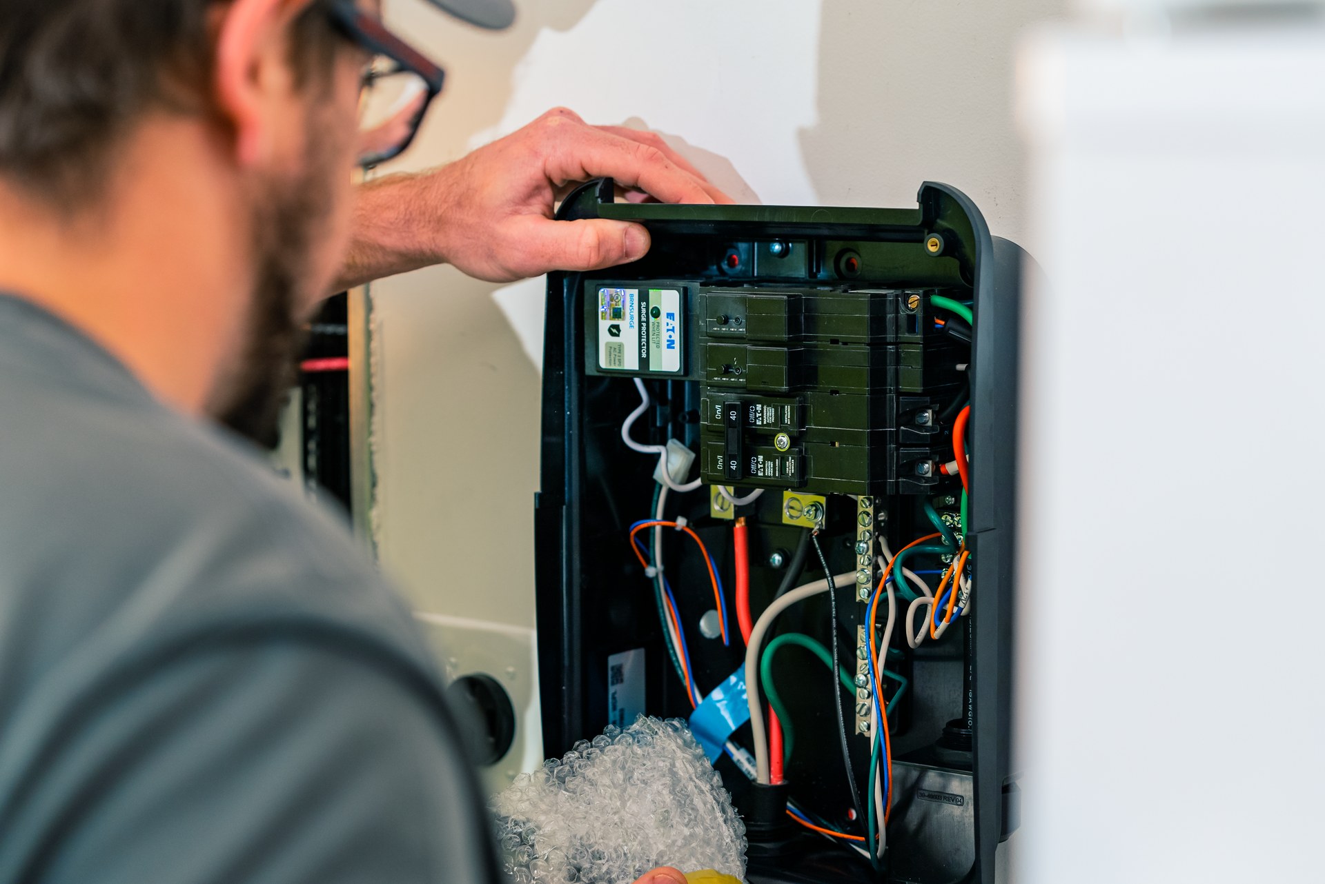

Photo 1. When installing EV infrastructure, begin by carefully reviewing existing electrical systems and taking the necessary steps to address any issues.

Wiring in older homes can vary depending on a variety of factors — such as when and how the original system was built and whether the wire is copper or aluminum — so begin by carefully reviewing existing electrical systems/wiring and taking the necessary steps to address any issues (Photo 1). Ensure the panelboard can support the continuous load of the charging infrastructure, and use a circuit breaker sized to protect the wiring and the load.

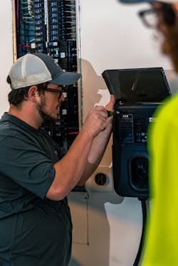

Finally, many homeowners will need to install infrastructure outdoors, leaving the charger open to exposure to dirt, water, ice, and other potential weather impacts (Photo 2). Review opportunities to install some of the equipment inside so the only components exposed to these elements outside are the J1772 connector, cord, and cord-mounting bracket. For wall-mounted units that are designed to be outdoors, contractors should use best practices for sealing any entry and exit points to the home and protect the wires appropriately where the wires enter the charger.
Photo 2. Talk with the homeowner about their preferred location for the EV charger to ensure the safest path to the vehicle.
