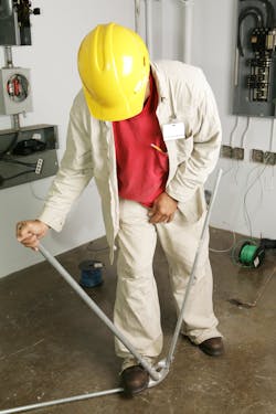

Most electricians spend a good amount of time bending metallic raceway. If you’re one of those electricians, are you doing this efficiently with good results? Many of the methods used in the field actually waste time and don't reach the level of quality that marks a well-done installation.

Step No. 6: Make the bend
