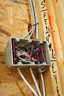

Let’s start with how to mount that box, assuming it’s new construction. With wood frame structures, the fact the box is typically nailed (or screwed) to a wooden stud is where the trouble begins. How can you reliably place that box in the correct position in three dimensions?
Easy. Look at the box. You’ll see depth guides right on it. If you don’t see those, it’s a cheap box that you don’t want to use; replace it with a box that has these guides. Look at your boxes when buying them to ensure they have this feature.
If you mount the box using these guides, the front of the box will be just about flush with the drywall. Not only that, the box will be mounted squarely in all dimensions. That is, if you hold the box in position using the guides, you’ll keep the box from leaning back, tilting to one side, sticking out, or being too far back.
