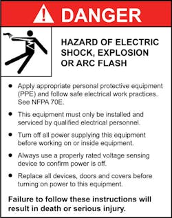

Fig. 1. This is a basic label that simply warns of a potential hazard.
Labeling requirements: NEC
The NEC contains electrical installation requirements. The arc flash labels required by the NEC do not contain circuit specific information, meaning they can be either field or factory applied. These labels are intended to warn about the existence of an arc flash hazard (see Fig. 1). Since being introduced in 2002, there have been changes with those requirements in every revision cycle.
NEC labels are formatted to comply with the ANSI Z535 standards and use colors, signal words, and messaging to alert people to hazards (Fig. 2). NEC labeling requirements are found in Sec. 110.16 and are also referenced in Sec. 110.21(B). The underlined text below reflects additions made to the 2014 NEC.
