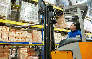

Applications like warehouses and other industrial facilities, which have occupancy rates less than 50% and feature high ceilings (15 ft to 45 ft), are ideal candidates for sensors. Consider a large warehouse with many long rows of racks and shelves loaded with merchandise as an example. When an order is issued, the picker identifies the aisle the product is on and drives a forklift into the space to fill the order. If the facility is not equipped with occupancy sensors, then the entire area is lit before and after the picker enters the space — even if there is no one else around. This arrangement wastes energy and results in higher costs.
Consider the same warehouse with high-bay occupancy sensors in place. The sensors will either detect movement of the approaching forklift or a change in heat in the area and turn on the lights. Sensor coverage patterns are broad enough to identify activity and turn on the lights well before the forklift enters the space so that the driver can see. Then, with the programmable timer, the lights will again be turned off after a set period of inactivity. Clearly, using lighting control sensors in this scenario significantly reduces energy consumption levels and operating costs.
