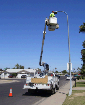

Roadway luminaires typically feature a receptacle on the top side of the enclosure. The receptacle allows the installer to plug in a photo detector device, which automatically turns on the lights at dusk and off at dawn. With new networking technology, a module that looks similar to a photo detector mates with the receptacle and still does the light sensing; however, it also serves as a network node that can switch power on and off (see Photo). In addition, users can connect it to a monitoring circuit that can keep track of many of the performance aspects of the light source and the electric power system. Each module serves as a node in a wireless network. Therefore, information on the status of the light source, such as an outage or malfunction, is sent via a wireless RF system to a local access point (AP). The AP aggregates information from hundreds of nodes and then communicates that data — either by wireless or wired network — back to a secure server at a network operations center (NOC).

The global positioning satellite (GPS) location of a light pole, which is captured when a node is installed, allows a problem fixture to be identified immediately (see Resolution Speed), allowing an operator at the NOC to send a crew to the exact pole with all of the needed repair components. The
operator can also obtain related electrical system information, such as ground fault detection and revenue-grade power metering, as well as automatically create a work order. Once street lighting is networked, the old method of performing maintenance — where the electric utility relies on call-ins from the public to report a streetlight outage, causing technicians to drive around to locate the non-operating luminaire — is eliminated.
