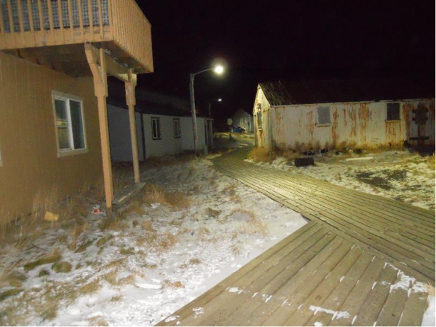

Akutan relies on its own diesel-powered generators to create electricity for homes, schools, churches, and other buildings. Many Alaskan villages have boardwalks to facilitate transportation between buildings over wetlands where there are no roads. As part of their effort to conserve energy, the City of Akutan worked with Sharon Poston, energy systems senior project coordinator at Marsh Creek, LLC, the organization that represents Evolucia lighting throughout Alaska. With Poston's guidance, the city chose to upgrade its boardwalk lighting with Evolucia Aimed Optics LED street lighting fixtures from Evolucia Inc. According to Evolucia, the cobra head LED products installed on Akutan expect to be virtually maintenance free for more than seven years. Wasilla, Alaska-based electrical contractor Current River Electric had the new fixtures all installed within a few days.
"Besides the excellent energy savings, the fixtures helped solve some difficult challenges,” said Poston. “The traditional 150W high-pressure sodium (HPS) lights failed often, and in Akutan's harsh climate it was difficult and dangerous to change bulbs in high winds, cold temperatures, and poor visibility."
Akutan's economy is largely based on fishing and the boardwalk serves as an important main thoroughfare in the town. With a small population, the savings will have a positive impact on the annual budget and the city's bottom line. This new LED lighting expects to save the community almost 67% annually in diesel costs. Evolucia Aimed Optics LED street lights provide Akutan residents more light and improved nighttime illumination, shining precisely where they need it, all while saving approximately 1,742 gallons of diesel fuel annually. There is virtually no light spillage or light pollution because, Evolucia's proprietary Aimed Optics platform directs the light precisely where it is most needed.
