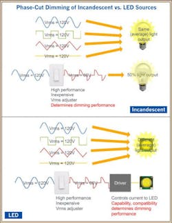

Figure. Phase-cut dimming, which modifies the input voltage to a light source, was developed for incandescent lamps.
All of these dimming problems can be disconcerting, to say the least. Nevertheless, it’s important to keep in mind that they’re not caused by any shortcomings of SSL technology. Rather, they’re due to the fact that almost all of the existing dimmers in this country were designed for another kind of lighting rather than for LEDs. That is, nearly the entire installed base of traditional line-voltage (phase-cut) dimming controls was designed for incandescent light sources (Figure). Therein lies the rub — there can be compatibility issues between these controls and an LED light source’s “driver,” which converts AC power to low-voltage DC power and maintains a constant current in the LEDs to keep them emitting a steady level of light.
But LED sources are more complex than incandescent bulbs. Incandescent filaments vary only slightly from one product to another, which allows them to interact consistently with different dimmers, all the way down to very low light levels. What’s more, those filaments don’t cool down right away when a phase-cut dimmer removes part of the input AC voltage waveform. As a result, the light they emit doesn’t vary much over the 60-Hz cycle. LED drivers, on the other hand, show considerable variation from one product to the next. In addition, the LEDs themselves react very quickly to changes in current. So even a slight incompatibility with a dimmer — or, for low-voltage circuits, even slight incompatibility with the transformer as well — can significantly affect the light output.
So you can see why it’s so hard to make LED drivers compatible with a wide range of line-voltage dimmers. This difficulty is only compounded by a lack of industry-wide dimming standards. For example, even the term “dimmable” has no universally accepted definition. To fill the void, the industry has adopted “dims like an incandescent bulb” as a de-facto substitute.
