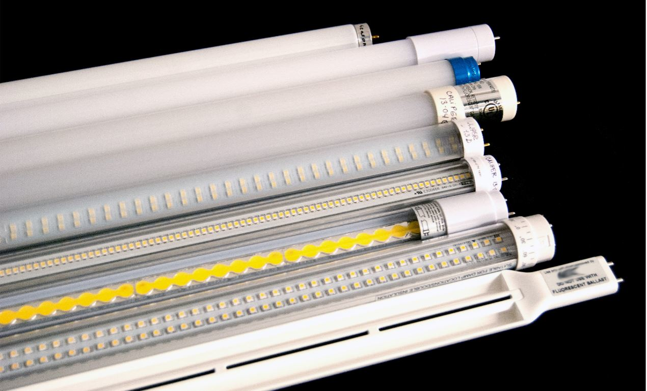

The Department of Energy's CALiPER program performed a series of investigations on linear LED lamps. Each report in the series covers the performance of up to 31 linear LED lamps, which were purchased in late 2012 or 2013. The first report focuses on bare lamp performance of LED T8 replacement lamps, and subsequent reports examine performance in various troffers, as well as cost-effectiveness. There is also a concise guidance document that describes the findings of the Series 21 studies and provides practical advice to manufacturers, specifiers, and consumers. Report 21.4 was just released in June.

This report focuses on the bare lamp performance of 31 linear LED lamps intended as an alternative to T8 fluorescent lamps. Data obtained in accordance with IES LM-79-08 indicated that the mean efficacy is similar to that of fluorescent lamps, but that lumen output is often much lower. This presents a situation where something must change in order for energy savings and equivalent illumination levels to be achieved simultaneously. In this case, the luminous intensity distribution of all the tested lamps was directional or semi-directional, rather than omnidirectional.
Also discussed in this report are several issues related to the electrical configuration of the lamps, such as the required socket types and power feed location. While no configuration is necessarily better, the multitude of options can make specifying and installing linear LED lamps more difficult, with the potential for safety issues. Similarly, the variety of color and power quality attributes adds a layer of complexity to the specification process. Many products offered good or excellent quality attributes, but some did not and thus could be perceived as inferior to fluorescent lamps in some installations. (31 pages, March 2014)
