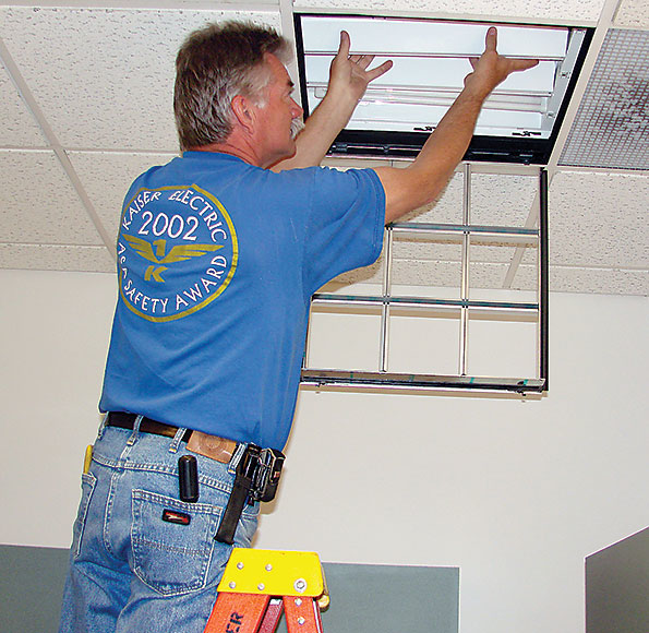

Upgrading a facility’s outdated luminaires is one of the easiest ways to save energy and money (Photo courtesy of Kaiser Electric).
