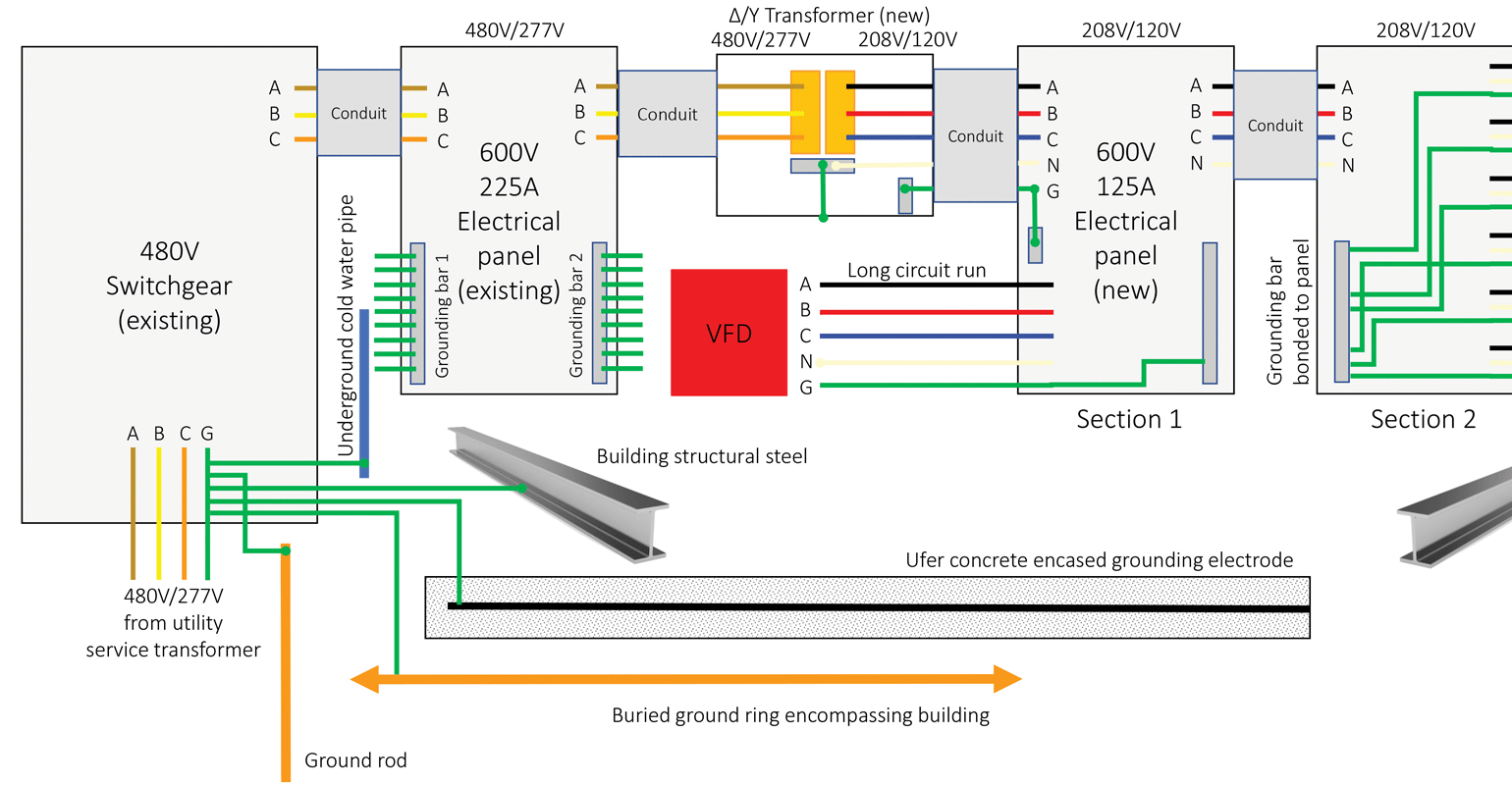

Figure 1 illustrates a typical facility electrical system. Here, a delta-wye, dry-type transformer and a set of 600V, 125A power distribution panels have been added to an existing 600V, 225A upstream panel. These modifications were made in the facility to support the installation of a new variable-frequency drive (VFD) and LED luminaires — both were added to the facility as a part of an incentivized energy-saving program.
One can see that the switchgear is grounded through multiple grounds (e.g., ground rod, cold water pipe, Ufer concrete-encased grounding electrode, etc.). The 225A panel is grounded and bonded to the switchgear through the conduit that encloses the feeder conductors. Branch circuits (not shown) utilize equipment grounding conductors (EGCs) from grounding bars 1 and 2. Another feeder from this panel was installed to power the delta-wye transformer — again, grounded and bonded to the 225A panel through the conduit. The neutral-to-ground (N-G) bond is made in the transformer and bonded to the transformer’s metal frame. A separate grounding bar is installed in the front corner of the transformer to provide bonding of the grounding conductor to the new 600V, 125A power distribution panel (Section 1 area in the figure). A VFD is installed with its EGC bonded to this panel’s grounding bar with the bar bonded to the panel frame. Section 2 is bonded to Section 1 through the conduit between the two panels. Each of the lighting branch circuits also contain an EGC, which are bonded to the grounding bar to establish grounding for the LED luminaires. The grounding bar is bonded to the frame of Section 2 to
establish grounding for the bar. And, each luminaire is bonded to the building’s structural steel. All of these grounding and bonding practices are commonplace in facility electrical systems.
With reference to power quality, what’s wrong with this installation?
If the new transformer fails (e.g., a fault occurs between Phase C and ground), a fault current will flow through the transformer’s grounding conductor through the conduits, panel, and switchgear to earth. However, if a 3-phase circuit breaker in another part of the switchgear arrangement (not shown in supporting article graphics) activates — and an oscillatory transient is generated by opening / closing of the breaker contacts — a transient current developed in one or all of the phases will try to flow through the facility’s power system, including the grounding and bonding system. Part of this transient current will normally seek earth through the ground rod. The other part will seek the building steel through the grounding and bonding system at the 225A panel, through the transformer, through the 125A panels and into the LED luminaires connected to the building steel. Still another part of the transient current will flow through the building steel and back through the luminaires seeking earth from the downstream side of the system. The point here is that ground disturbance currents, which can originate from disturbances involving the phase conductors, much higher than 60 Hz will flow all throughout the grounding and bonding system, including the metal frames of the panels, transformer and switchgear with various (much higher than 60 Hz) frequencies, all seeking earth through the lowest impedance at those frequencies.
In the system of Fig. 1, the disturbance currents, trying to flow through the grounding and bonding system, will encounter parasitic distributed capacitances and inductances other than those already inherent to the grounding and bonding conductors and mechanical structures of the bonding hardware. These distributed capacitances and inductances are shown as red dotted lines in Fig. 2.
These capacitances and inductances, shown as Z1(f) through Z11(f) in Fig. 2, also contain a resistive characteristic. Just as the variable Z indicates, these impedances are dependent on frequency — the frequencies that make up the disturbance current. This “added” impedance in the grounding and bonding system causes an additional undesired voltage drop to occur throughout the grounding system. This voltage drop(s) shows back up across the VFD and the LED drivers. Depending on the magnitude and frequency content of the disturbance current, one or more electronic components (and possibly surge protection devices in the AC network and embedded in the digital electronics), either in the VFD or in the LED drivers, will fail. The higher the disturbance current, the higher the voltage drop(s). In fact, the presence of these distributed capacitances and inductances typically increases the impact of the disturbances on the electronic equipment. Minimizing the effects of the Z(f) impedances will minimize the voltage drops. The disturbance currents will still flow, but the objective is to aim them toward the grounding electrodes so they are not dissipated in the electronic equipment.
Figure 3 illustrates a recommended method for grounding and bonding to achieve good power quality performance for electronic equipment. One should note that a continuous grounded conductor is included in the switchgear, through the conduit, in the 225A panel, through the conduit to the delta-wye transformer and into the 125A two-section panel. Implementing a continuous conductor-based ground will provide the best performance. Because materials cost is often an issue, another option is to completely remove any paint, rust, etc. beneath grounding and bonding hardware and ensure bolts attaching this hardware to the metal panels and frames of transformers are properly tightened. With this method, the impedance uncertainties, which are depending upon disturbance frequencies, are no longer dominant in the grounding and bonding system. This method of grounding and bonding has a higher performance for managing ground disturbance currents and directing them toward the building infrastructure instead of developing undesired high-frequency voltage drops across electronic equipment.
