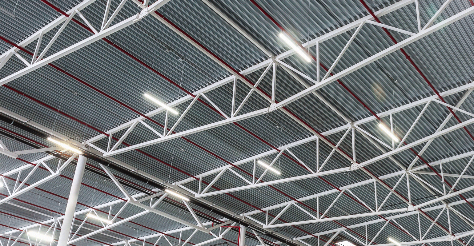

Asymmetrical layouts
An asymmetrical layout may be the best choice for a given area. With that in mind, consider what might happen if you change the existing symmetrical installation (Photo 1) into an asymmetrical one. Just relocating a few luminaires may be all the upgrade needed.
If you are considering asymmetrical, how do you know what works? First, understand that the standard grid pattern used in areas with large expanses of floor space (e.g., offices, warehouses) will light the area regardless of where the work is being done or where the most light is specifically needed. The assumption is that with enough ambient light, anybody can see just fine.
But if you have a situation like a climbing gym (Photo 2), the ambient light is not nearly enough without adding significantly more luminaires. Asymmetrical lighting is the solution. This also is true wherever detail work is being performed. Rather than force employees to move their desks, tables, or other work surfaces directly under a light (or add task lighting), position the existing luminaire over those surfaces, or make it easily reconfigurable.
Asymmetrical lighting layouts can reduce installation cost and power consumption — sometimes dramatically. In the climbing gym situation, it would’ve taken a huge increase in luminaires in the symmetrical grid to eliminate the visual problems on the climbing walls. That solution would over-illuminate other areas, wasting light and electricity. And it would mean a big layout for hardware and installation.
The problem was solved by moving some existing luminaires from the grid pattern so they surrounded, and were aimed at, the climbing walls. This asymmetrical arrangement combined with a “field-designed” aiming method put the light where it was needed.
