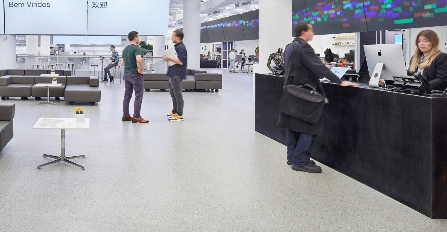

    HCL is also finding its way into the office space market. In 2016, New York advertising firm R/GA moved into a redesigned space in Manhattan that incorporated a circadian lighting scheme that featured color-changing luminaires. Designed by Tillotson Design Associates, a New York lighting design firm, the lighting was initially programmed to be 2,700K in the morning, transitioning to 4,000K midday, and backing off to 3,000K in the evening.
    Dagmara Nowak, a Tillotson senior designer, says R/GA was interested in experimenting with an HCL approach. After it was installed, however, R/GA tinkered with the system, backing off the 4,000K and possibly changing other elements of programming, she says.
    That project was an early HCL venture for Tillotson, and Nowak says HCL presents opportunities for meeting evolving client needs.
    “We think the approach of having lighting follow the rhythm of the day to some degree has a future,” she says.
